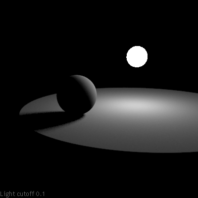

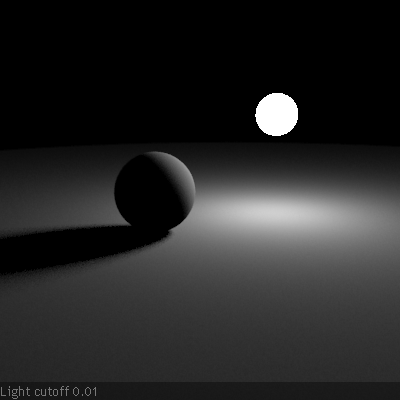

          Here are three examples with the light cutoff (0.001, 0.01 and 0.1 respectively).
          Vlado

                i wish cutoff would have had a falloff. Like in the third example there is a hard line where the rays terminate, not a very feasible result. A falloff would be much better.
                    Since you don't get any such thing in nature, the result in not feasible either way Better looking is another topic ; in any case, the original idea of the cutoff was to be used only to extents where it would not be visible; it's original goal was not to be used as a falloff. (Just for the record, future builds of V-Ray will have a separate reflection falloff for VRayMtl).
