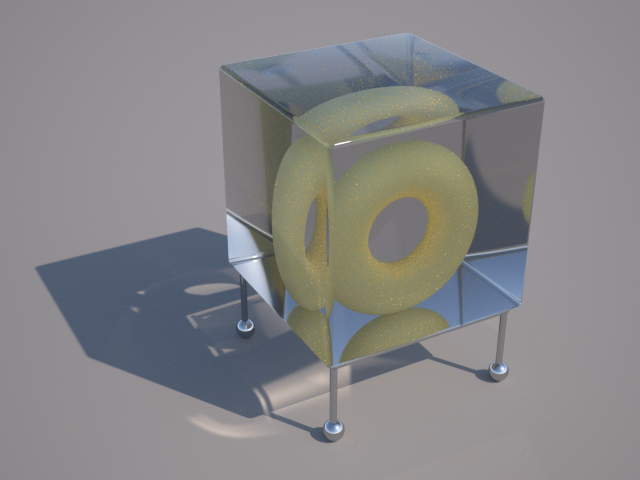

          here is a stab at the cline encapsulated torus. Not sure that the lighting is on par with the reference I was using but I certainly shows where plain BDPT falls down on specular-difuse-specular transport.
          P.S. This isnt the nightly build so it may have been fixed but sellf illuminated surface including VRay Sun show up black in the reflections.

                Here's a 6 min render (mac pro 12 core 2.93GHz) in maxwell as a comparison.
                I haven't got the scene exactly as the example either, but it's good to see the comparison.
