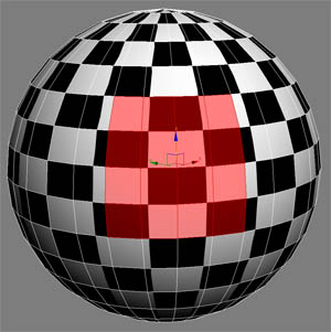

    How I can make my selected face color 50% transparant?? I wanne be able to see the texture shine through the selected face color. I know it's possible because the guys from cg-academy are doing it on their uv unwrapping dvd, but I can't see what they are doing. Since I see no clicking it must be a keyboard shortcut. I checked the help and can't find anything about it!
    This should show the checker texture too, at least a little bit:

          f2 makes the red dissappear completely, so you don't see the selection anymore. Maybe I'll better email the cg-academy people

                    Originally posted by flipside
                    I need a trick but can't find it.
                    Here you go:
                    You need to be in Edit Mesh & Running Direct3D and it happens automatically, no settings or keyboard shortcuts needed. Hope it helps, took me a long time to figure that one out.

                      not quite.
                      Depending from teh card, you might need to have the viewport transparency set to BEST for it to happen.
                      Some cards just don't have the "fast" transparency mode, and need no change of settings.
