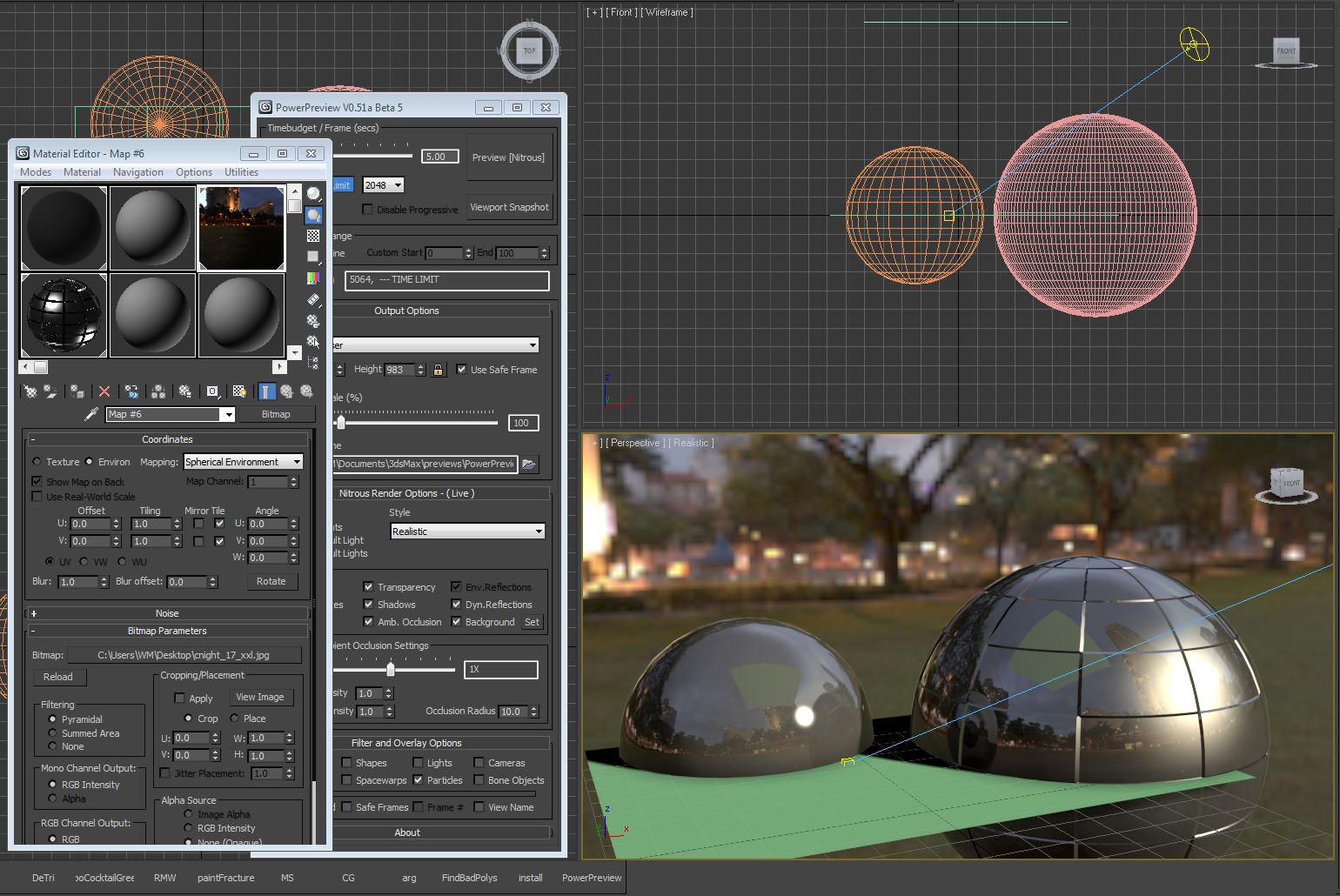

    A quick tip for every1 out there who love to see real time stuff inside 3ds max !
    In any case here is a screen shot that tells u all u need to know. - Left sphere mental ray - right sphere vray
    U need PowerPreview from http://www.scriptspot.com/3ds-max/sc...reviews?page=2
    U also need to Click
    View > Show materials in viewport as > Realistic Materials With Maps
    And make sure to tick on Dyn.Refl inside PowerPrevview.
    As far as I can tell all works even Fresnel - lol - except for glosiness - chaos getting lazy ? :> / joke ofc...
    Anyway Enjoyyyyyyyyyyyyy.
    Edit - stuff that dont work.
    Refraction - Distortion/IOR

    Can't make the glossiness work unfortunately... also keep in mind that Nitrous reflections are cube mapped. They work well on a sphere, but not on a plane.
