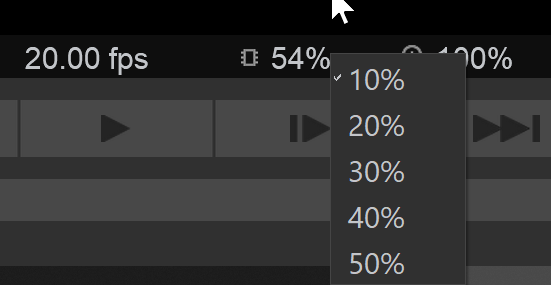

                      There's one other reason why loading a sequence won't cache or will only partially cache, even with preload enabled - memory is taken by other applications.
                      The toolbar indicator (the one with the % sign) shows how much memory is currently free. Right clicking on it brings up a menu that allows you to specify how much memory the player should leave free (for other processes).
                      If memory is reserved by other applications - there may not be enough for the player to use for caching.
