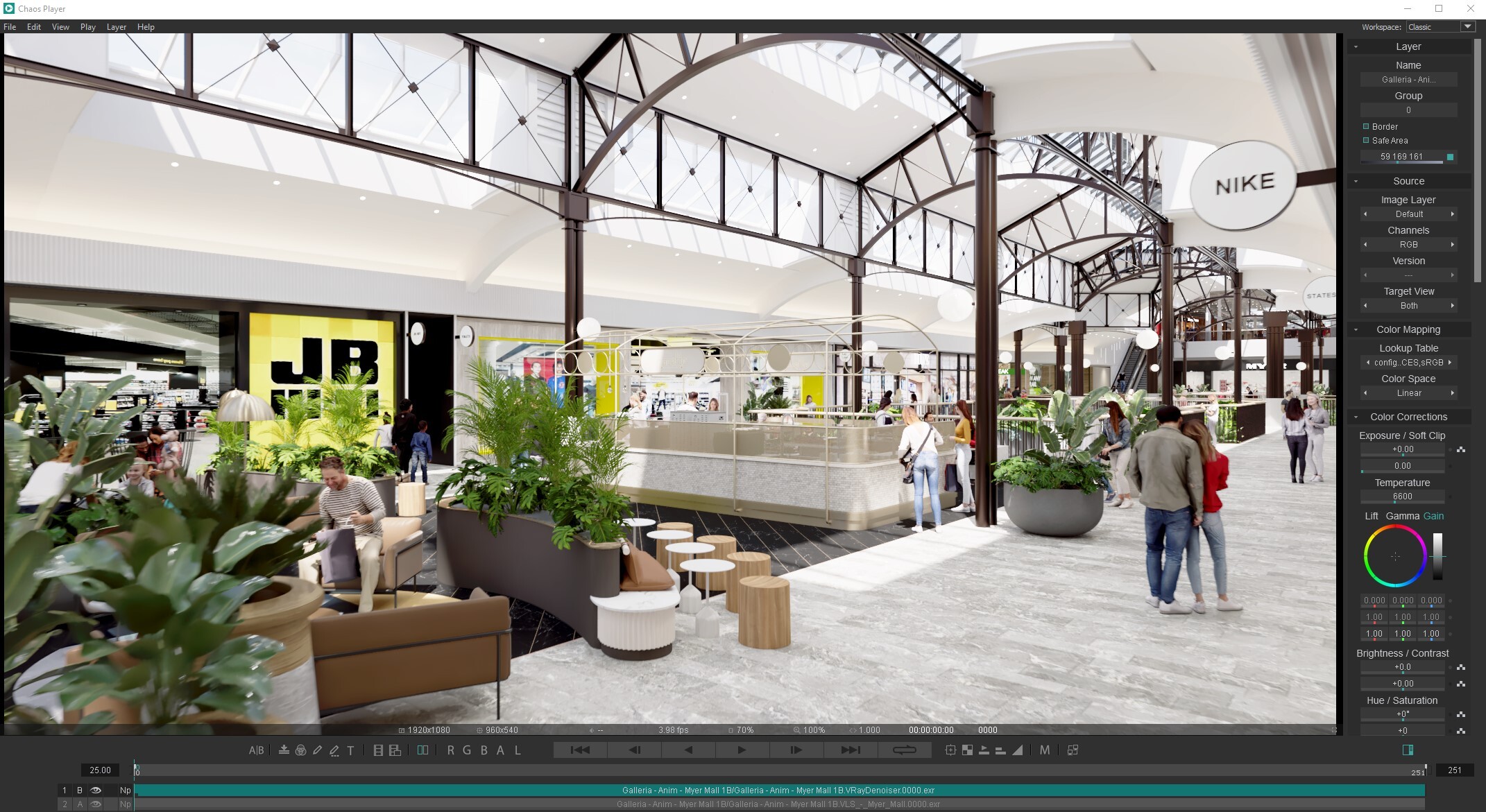

    Trying to display EXR sequence in ACES colour space with sRGB view transform and it looks incorrect. Colour corrections also do not seem to work in high dynamic range. When I adjust the exposure everything is clipped, almost as if the adjustment is being done after the ACES view transfrom instead of before it.
    The image below displayed in DJV is correct.

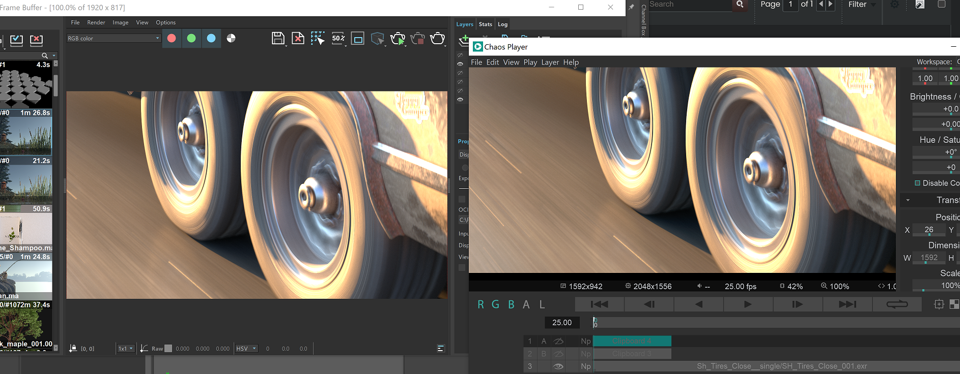

          Can you compare to the VFB? I'm trying to do a comparison here, but can't get Djv to match, but I have a match between Chaos Player and VFB with the same image.
