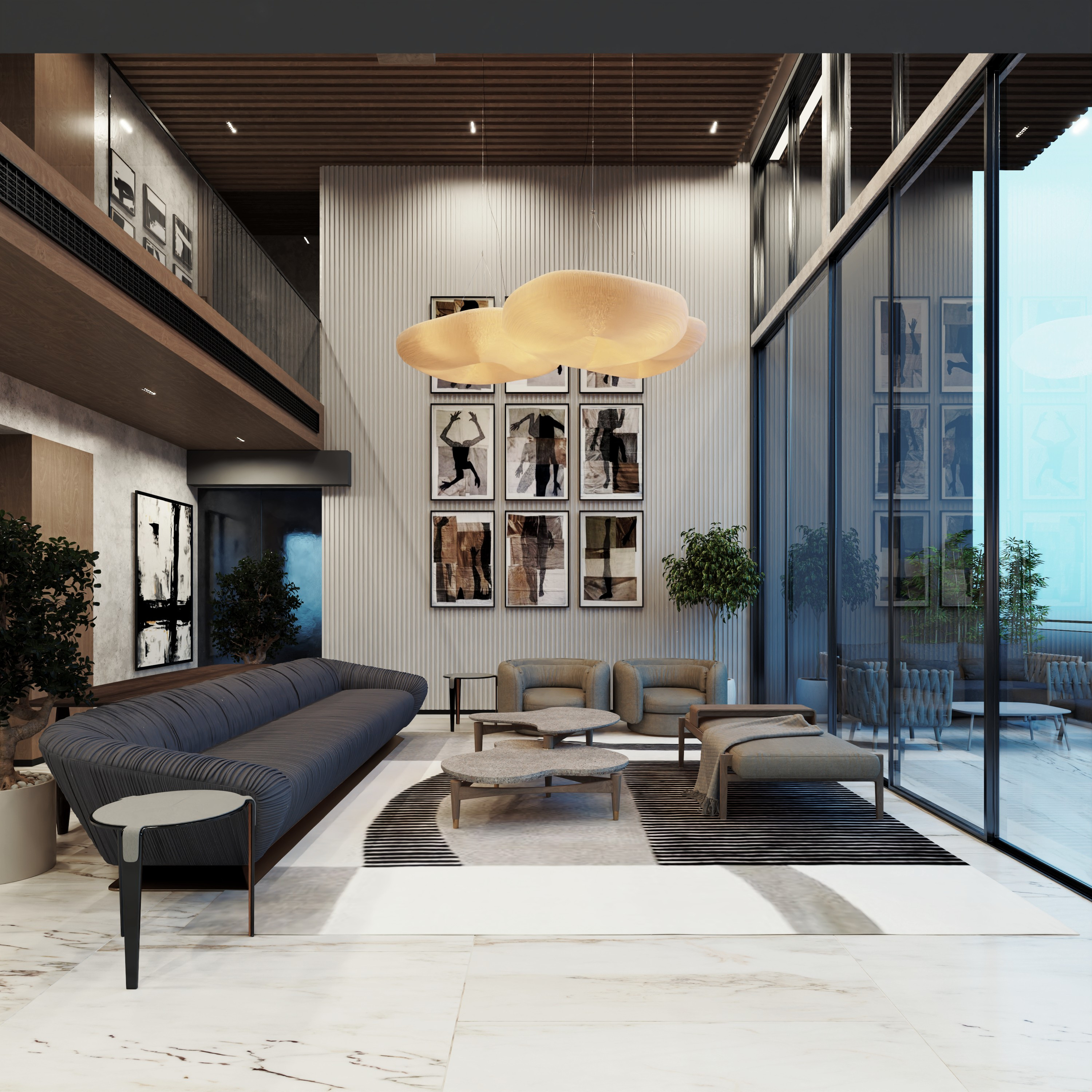

    Hello, I thought of doing a test with CPU, GPU and vantage.
    Highlights of the test -
    1. CPU and GPU (RTX) is aces workflow. Vantage is sRGB with filmic tone mapping in habble (default)
    2. Scene is lit with only one HDR sky dome.
    3. No post processing on any image.
    4. PBR textures on most of the objects, only carpet is not PBR
    5. Absolutely no changes between different scene, change changed renderer and hit render.
    Conclusion.
    1. I consider CPU render the best as it supports all vray features. and lights and materials render as they are suppose to without any drawbacks.
    2. GPU render is not so great in terms of quality of some materials, you can see how the sofa, sofa base, planter on left dint render so well. it can be fixed of course.
    3. Vantage looks pretty decent in comparison, its not aces but the look is close, textures and colors are little washed out, but can be fixed a little.
    4. CPU amd 3600 single cpu which took approx 1 hr. GPU 3080 rtx surprisingly took little over an hour, vantage is 3mins. 400 samples
    If vantage can support aces workflow in future, I thing the gap between CPU and Vantage would be much closer.
    I also cannot emphasize enough that how important render elements can be for composition later. a backtobeauty pass is a must.
    One imp thing to note is, you will see the floor pattern change in all 3 renders, that's due to the seed change for every frame on floor object.
    Do share your thoughts after comparison.
    Thank You

    I note that on the CPU image, there is a reflection on the foot of the sofa that does not appear on the other images. Any idea why?

      Hello,
      I am glad this was informative to you.
      The foot of sofa is simple gold material, with noise map in bump. Since noise map is not supported well in GPU/Vantage .. results are different.
      As long as materials are concerned, I have requested full support for vrayblend material, translucency and noise map from chaos team.
      For lights, I think mesh light is very imp. Light materials doesn't give desired results plus it renders incorrectly.
      And of course backtobeauty render element support.
      I also did a render with interior lights. render time is again 3mins with 400 samples. 3080rtx. (no photoshop, only filmic tone with hable in vantage.)
