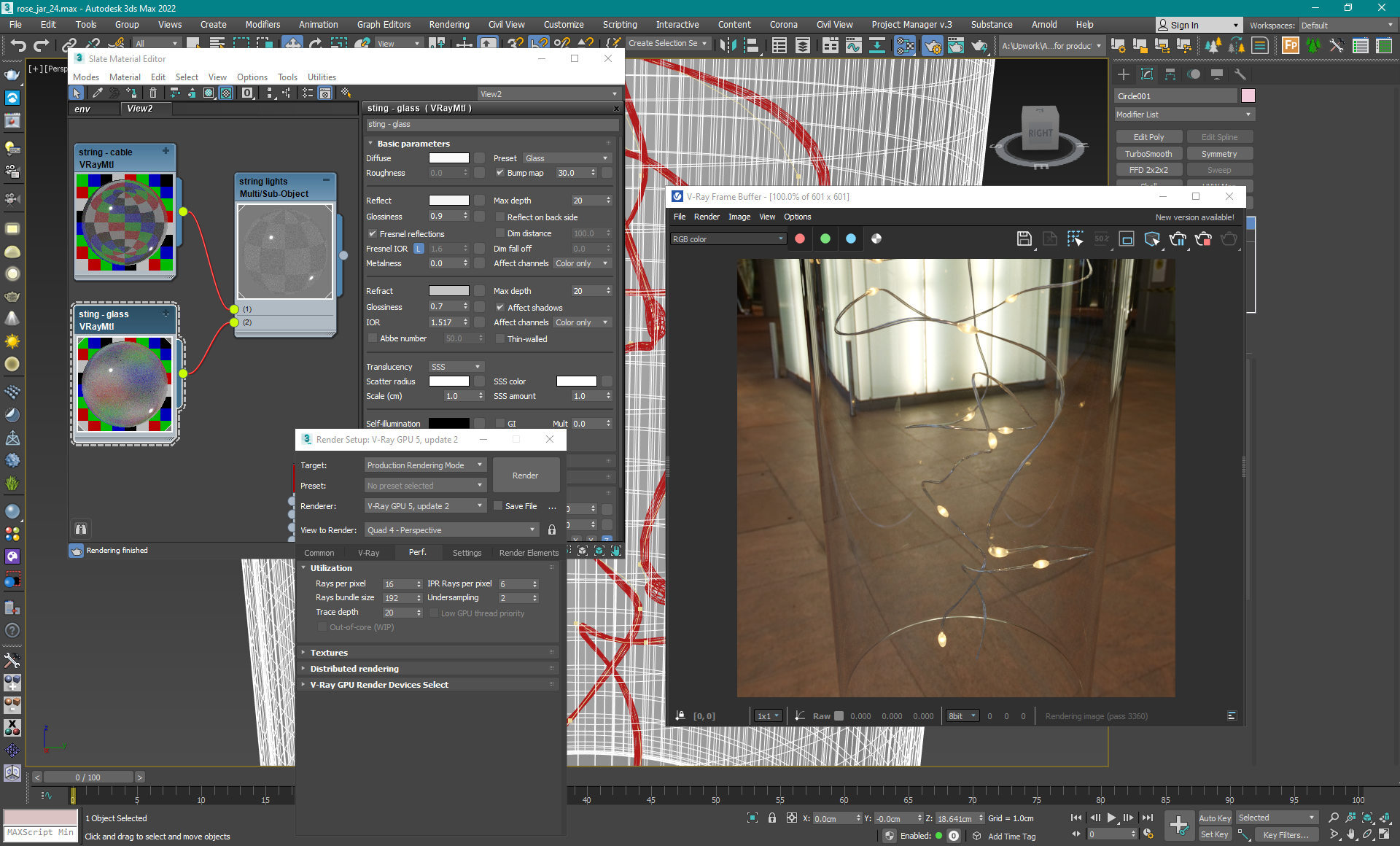

    I have an issue with lens effects not showing up until I hide a glass object. Please see the screenshots below. Trace depth in Global Switches is set to 20 and all glass materials have reflect and refract depths set to 20 as well. The lights in the small bulbs are separate objects with VrayLightMtl applied and Direct illumination turned on. This VrayLightMtl is not part of a Multi/Sub-Object material.
    Click image for larger version  Name:	jar_lights_1.jpg Views:	0 Size:	416.6 KB ID:	1129611Click image for larger version  Name:	jar_lights_2.jpg Views:	0 Size:	353.5 KB ID:	1129613

          Hello,
          Overall the LensFx works purely on images and RGB data - it only cares about the intensity of a given pixel. If it is below the threshold it is ignored. So could you check the intensities of the lights behind glass - maybe since glass attenuates some of the energy the pixels there are below the threshold ?
          Yavor
          Yavor Rubenov
          V-Ray for 3ds Max developer
            Hello Yavor,
            I've placed regular spherical Vray lights in the bulbs and the problem still persists. The glass in my latest tests is not tinted, it's fully transparent so it shouldn't really affect the light intensity, but it still blocks the light as if it's heavily tinted. I measured the linear values of the pixels at the center of the bulbs and with a glass cover the pixel value is ~11 and without the glass it's ~96. This can't be normal, can it? Maybe the problem is somewhere else? Should I send the scene for inspection?

              Reflection takes energy away. Try with zero reflection.
              Nikola Goranov
              Chaos Developer
                I had this issue a while back. In my instance, it was to do with the max ray intensity value, if I recall. Basically blurring a refraction enables the max ray intensity value, which defaults to 20. This means itll kill off all of your potential lens fx values. If you bump the max ray intensity up to say, 500, youll find the lens fx come back, but render times and noise go up.

                  Hi, npg . Thanks for the suggestion. I've just tried with pure black/zero reflections. No luck. The fully transparent and non reflective glass still takes away the majority of the light energy. I've made a quick test with the CPU renderer and there was no issues there even with trace depth at 5. Please see screenshots below.
                  Click image for larger version  Name:	CPU.jpg Views:	0 Size:	258.0 KB ID:	1129854Click image for larger version  Name:	GPU.jpg Views:	0 Size:	228.7 KB ID:	1129855
                  Increasing Max ray intensity a lot indeed solves the issue. Unfortunately, this is not a very good workaround as I end up with tons of fireflies. Why does glare work fine with the CPU render and default MRI values, but the GPU renderer does not and needs to be cranked way up? Is this by design?
