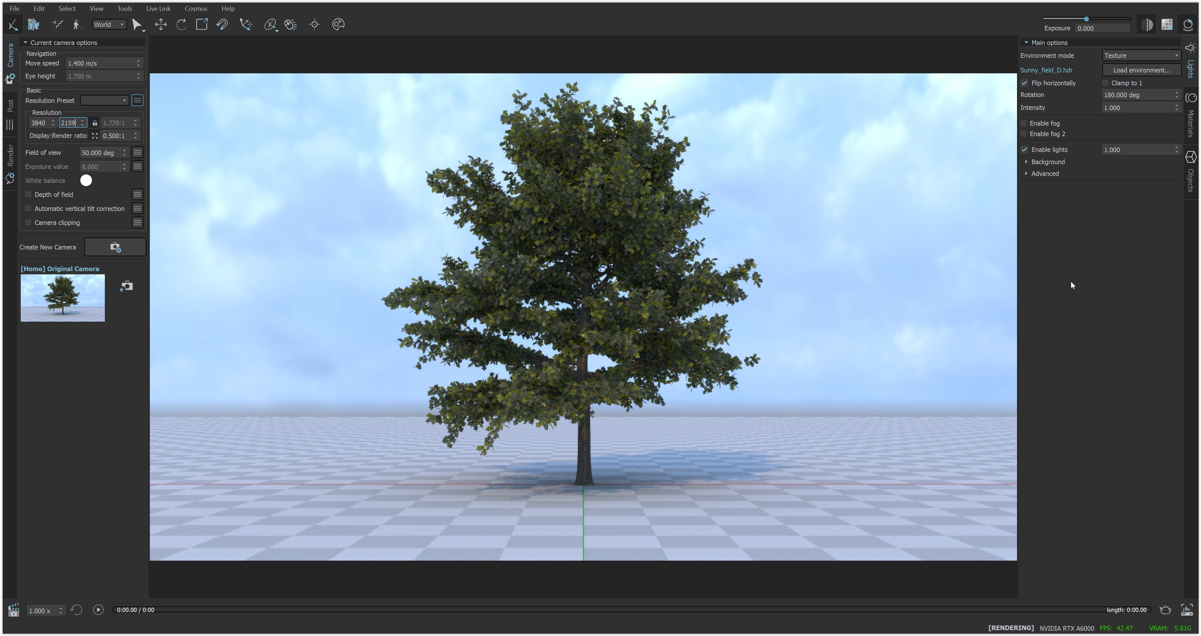

                    The quickest way to measure the the performance degradation is to launch the default scene and set the render resolution to 2160p (3840x2160 or 4096x2160) and wait 1-2 minutes.
                    I have attached two screenshots taken by me after waiting at least 2 mins on my both PCs one with the A6000 with the 472.84 driver and one with the RTX 3090 with the 511.65 driver, which clearly illustrate a downgrade.

                        The A6000 and the RTX 3090 are not the same GPU.
                        The A6000 has more CUDA/RT cores, but the RTX 3090 has faster memory.
                        Also, the temperature in each PC case can be affecting the performance by a lot.
                        You need to compare the drivers on the same machine, if you want a proper comparison.
                        Also, you mentioned a 35% slow down initially and the screen shots show only around 13% slow down.

                            In those screenshots which is the basic Vantage scene the down perf is around 13-14% but in more complex scenes the perf is down approx. to 30-35%.
                            The temps in my both PCs does not exceed 75-80 degrees C in render process.
                            I will install the R510 U2 (511.65) drivers on my A6000 machine and test again some scenes but I'm pretty sure the results will be the same.
                            But in the meantime test the scene I have uploaded on the 472.84 drivers then on 511.65, preferably on a Quadro VGA and a GeForce VGA and I'm sure you will notice the downgrade too.
