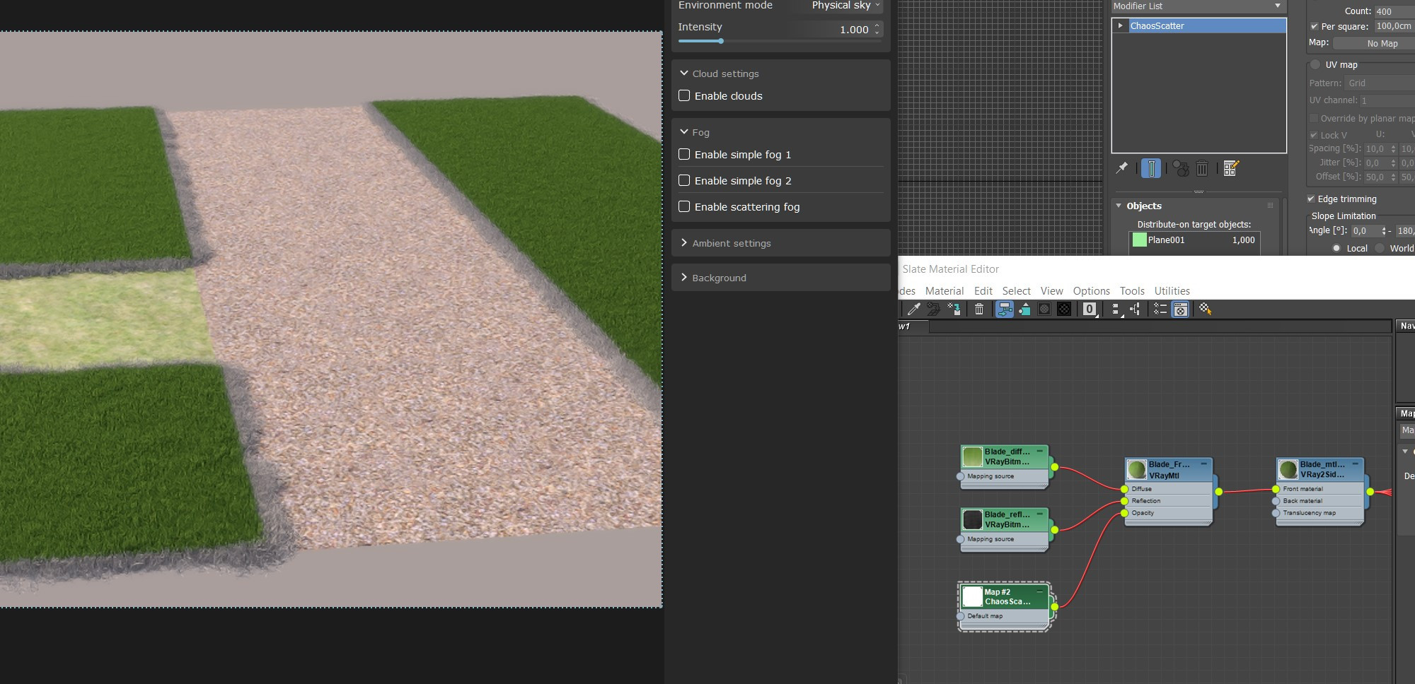

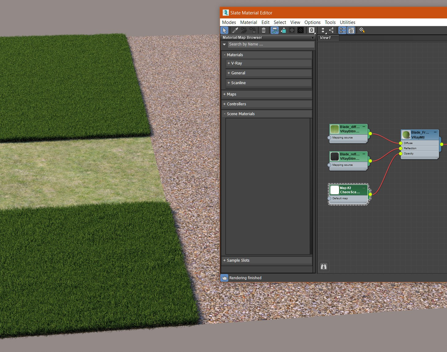

    Hi,
    if I render in Max (bottom left image), I just need the texture to have the edges trimmed,
    If I render in Vantage it simply doesn't work, either using edge trimming texture, neither using edge trimming option inside chaos scatter object...
    What am I doing wrong?

    Hi marcello_pagnan,
    You have to enable Opacity rendering from the top toolbar>Render settings and the edge trim should look the same as in Max.
    Alexander

      I am so dumb!
      it's workin now
        We will improve this behavior in the future - when opening a scene to detect if there are materials with opacity or scatter's edge trimming and enable Opacity rendering.
