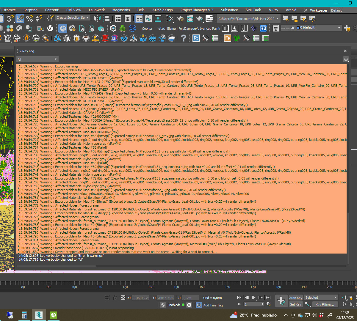

                here it is
                  sorry wrong file
                    From the log file it looks like the live link animation sequence was aborted.
                    Do you get a crash or a message box with an error ?
                    Can you send us the scene so we can try to reproduce it ?
                    Greetings,
                    Vladimir Nedev
                      the message appears to me is the same as the initial post "minidump ...."
                        here is the link of the scene
                        https://drive.google.com/file/d/1kps...usp=drive_link
