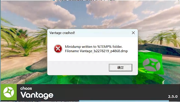

                            • #29
                              After updating to 2.5, the software cannot be opened. It still remains the same after uninstalling and reinstalling.
                              • #30
                                Hi lin_mobai,
                                Can you send us the debug log file from %AppData%\Chaos\Vantage so we can investigate? You can also checked this thread here as it might be similar to yours:https://forums.chaos.com/forum/chaos...-start-anymore
