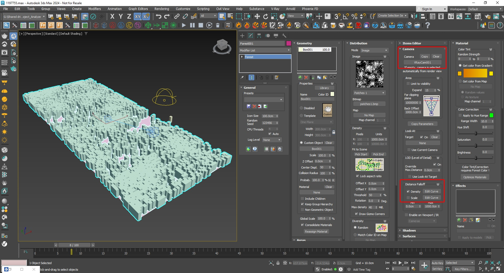

        What do you mean by that? Is it the camera clipping/density falloff etc. feature?
        I tried it in a simple scene and this seems to work on my end.

          It was camera visibility clipping, the view angle one so only what you see infront of the camera.

            I save selected just the FP, camera and a little bit of building. Tested if it was still freezing, it definitely is! The forest pack seems quite intense(file size) but it renders perfectly fine without the clipping enabled. Just uploading it now to send.
