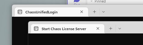

    Hi!
    each time I start computer these windows opens and remain opened, any idea how to fix?
    thanks Click image for larger version

    This just started happening to me as well. Are you on Windows 11? I think it might have something to do with the latest Windows update.
    Vlado
      yes windows 11 latest. I have another pc win10 and these CMD windows not showing
      thanks,
        Ok, thanks for the confirmation - I'm trying to get a bit more info now.

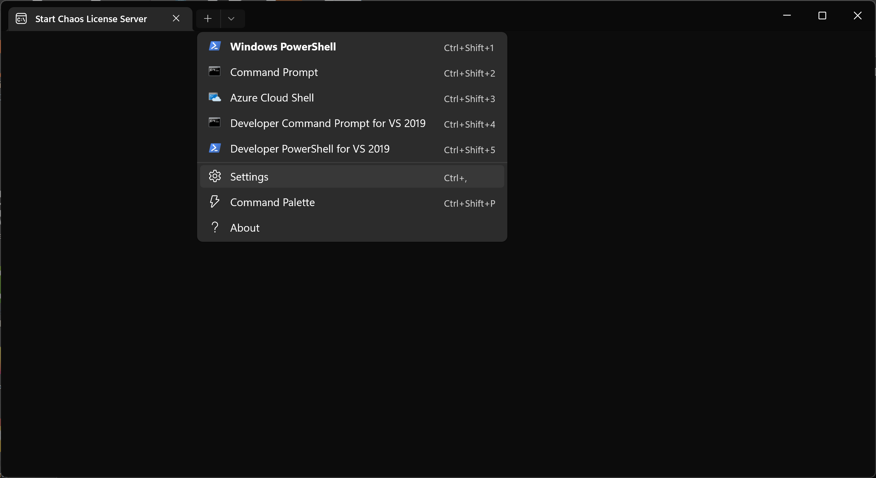

          Hello,
          Can you please open the Dropdown menu on the Chaos Unified Login and Chaos License server CMD windows and select the Settings option:

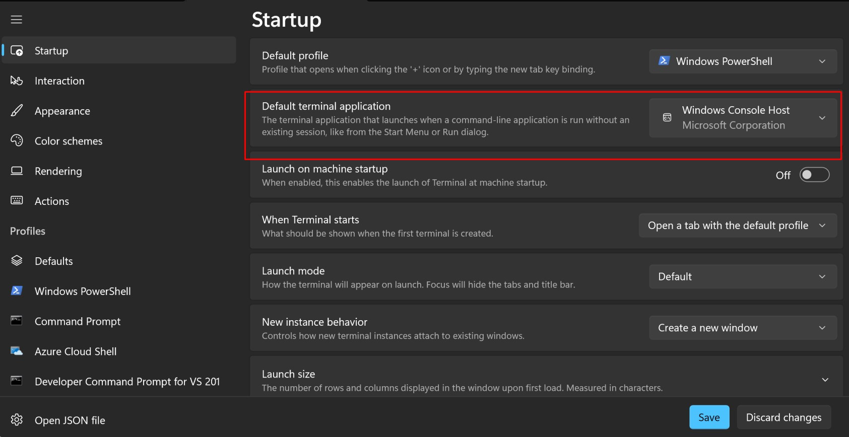

          In the Settings window, please change change the "Default Terminal application" to "Windows Console Host". Restart your machine afterwards and tell us if the CMD windows are still not closing automatically.

            worked, thanks
