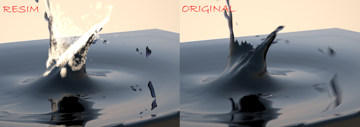

                I install the newest official release 21010, but it seems that with resimulation the motion blur wont work. Like it cant get the velocity information?
                EDIT: A straight sim with foams seems to work OK with moblur, the problem is in resim.

                  Your velocity was probably deleted . You must not forget to change the "Temporary Channels" parameter in the resim section to not include Velocity when you need it. Sory, the default setting was choosen wrong and we forget to fix this in 3ds Max.

                    Thanks Ivaylo, it works after I change the temp channels to none. Phew, I dont have to sim my whole hires grid again
