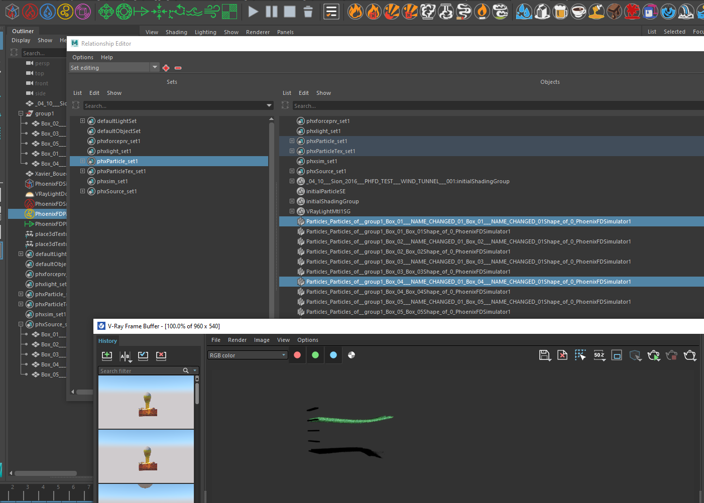

                    Your Source emits from all 5 boxed, this is correct.
                    However, your Particle Shader is connected to just 2 of the 5 particle systems the Source creates from the 5 boxes.
                    So when I turned off rendering of the Simulator and rendered only the Particle Shader, here is what I get:
                    Click image for larger version  Name:	Screenshot_8.png Views:	0 Size:	191.3 KB ID:	1110267
                    This is one mistake you made - you need to plug all five particle systems into the Particle Shader's phxParticle_set1.
                    Here is how this looks when I added all 5 systems:

                            • #44
                              Tis is what I have achieve, but it is a lot of connecting and managing.
                              If this is the way to do it I dont know, but it is aaaaaaa LOT to do.
                              At the end I can change for all the 5 sources the Particles Color which is cool !
                              The only messy thing is that I need to connect everything by hand and are 3 steps to do.
                              1. Connect the particles
                              2. Connect the Sources
                              3 Connect the proper PhoenixFDParticleTexture to each "Particle Shader" (OOPS! I called until now "Particles Color")
                              And As I said for any reason I can get run the the "Velocity" from the "PhoenixFDParticleTexture" / Color from Particle Channel / Use Color From Particle Channel as a velocity.
                              Kind of weird.
                              Tis is the result I look forward to have with only one:
                              "Particle Shader"
                              "PhoenixFDSource"
                              and 5 Sources (Boxes)
                              2021_04_10___XBO___PHFD___RGB_PROBLEMS___FAQ_003__ _01___sent.PNG (2560×1440) (class-a-strak.com)
                              This is my work around and as I said Im not sure if this is correct.
                              And why any Time I change the name of the Sources will be create a new "Particles of Particles" ?
                              2021_04_10___XBO___PHFD___RGB_PROBLEMS___FAQ_003__ _02___sent.PNG (772×200) (class-a-strak.com)
                              After having a lot of "Particles of Particles" then I dont know which one to connect.
                              Fortunately enough I found a way to rename the Sources so now I know how to connect every single "Particles of Particles" properly.
                              But I dont know.
                              If I will never find this I will lost with all those "Particles of Particles" that Phoenix Create.
                              OH !
                              HOLD ON !
                              Now Im texting you this.
                              It is a different "Particles of Particles" created for the Velocity and this is the reason I dont see the Velocity in the render ?
                              I need to chack this too.
