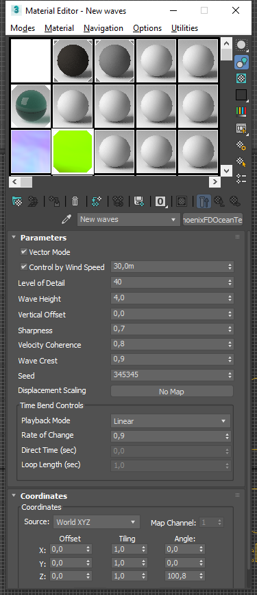

            I tried increasing the speed of water inside the PhoenixFDoceanTexture. (from 15 to 30). The grid is around 20 mil. for a test simulation, but the collision has no effect. Do I need to activate Active Body (make Body Static) inside the Phoenix Props for 1 Node?
            In previous Chaos tutorials the rocks (river) and rocks (beach waves) they are not active inside chaos Phoenix Properties. Does the scene scale has any effect? Everything is now 1 meter.

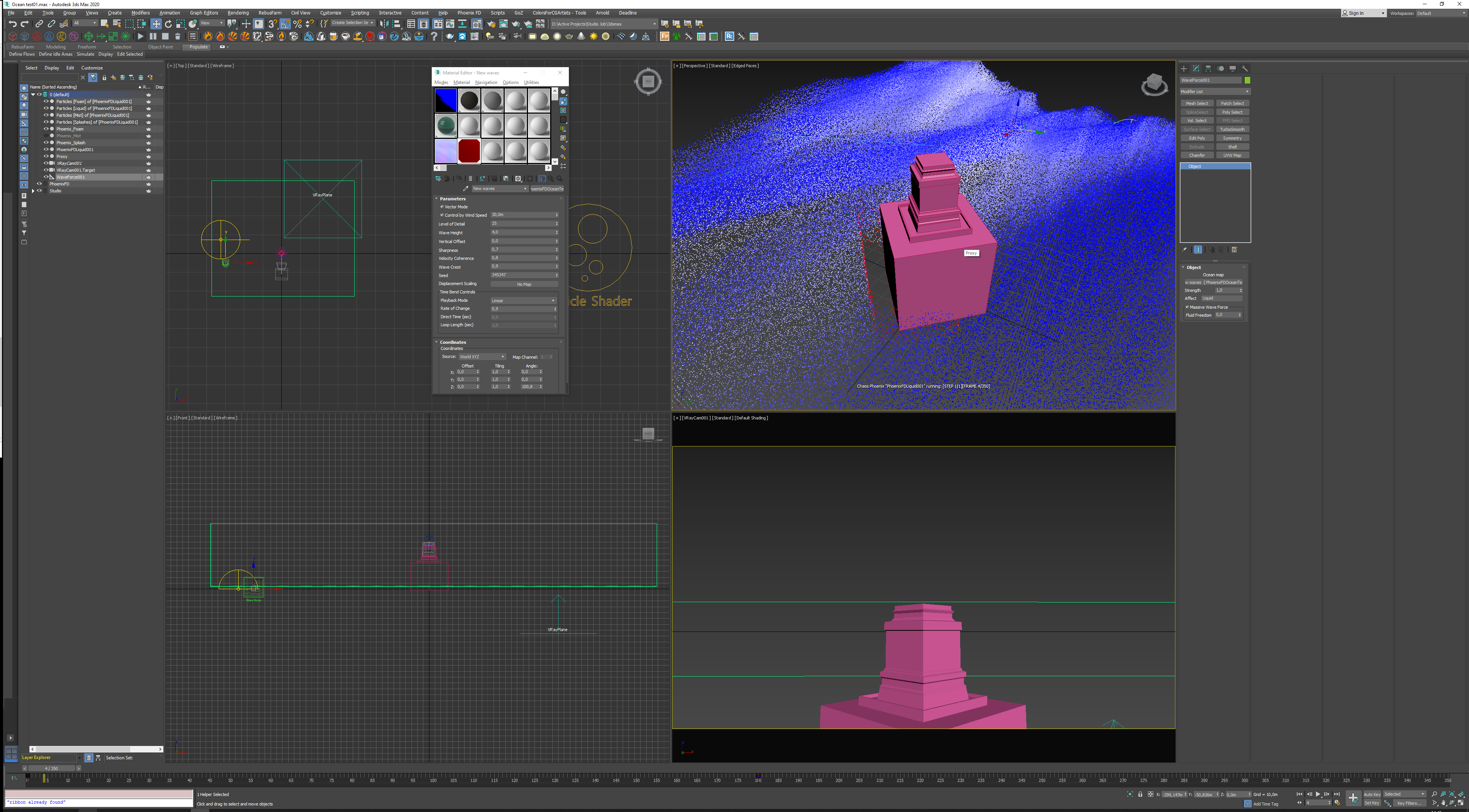

Name:	Schermafdruk 2021-11-15 14.27.29.png

                  I see something happening when changing the Massive Waveforce to zero.

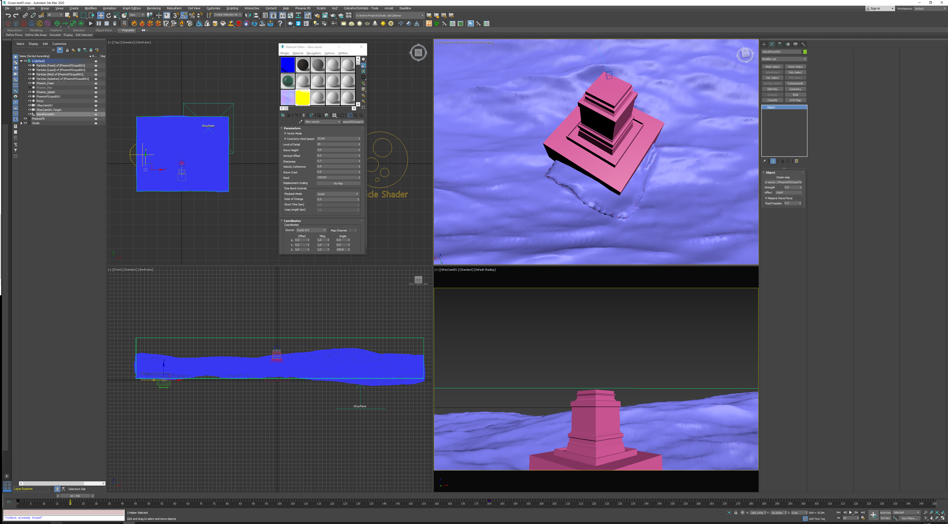

                    Ah, okay, so you are looking at the ocean with displacement in the viewport. How does it look if you go to the Simulator's Rendering rollout and turn off "Displacement"? Do you see the effect of the waves splashing onto the geometry?

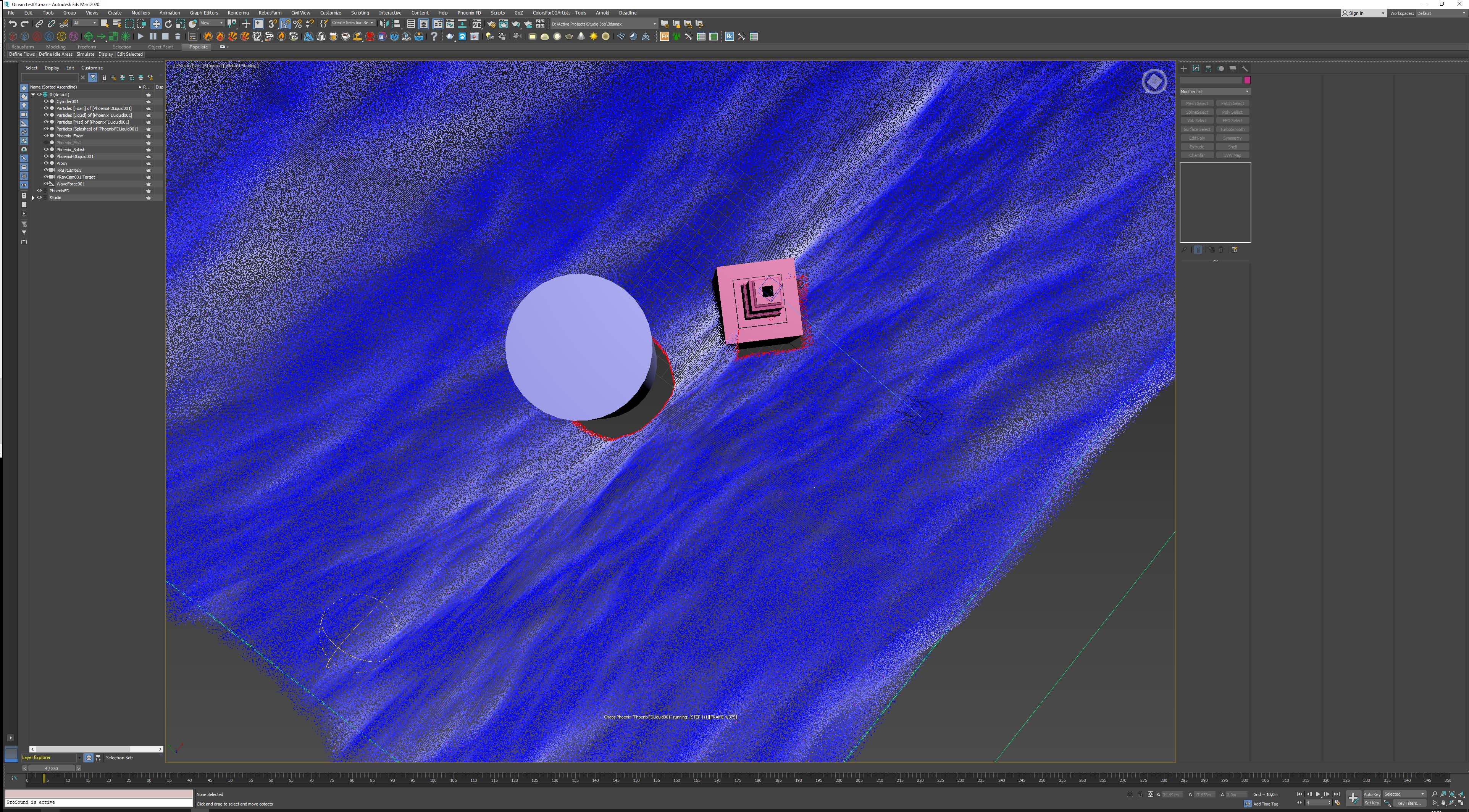

                      But now the Wetmap is behaving strange.

                        • #13
                          Why is this happening? The wetmap particles are not in place?
                          • #14
                            Hey, are the wetmap particles offset even with the Displacement OFF? And even after you simulate again?
                            • #15
                              The problem was inside the fluid particles. I have deleted the cache but that didn't solved the problem. I deleted the Liquid node and now it works!
