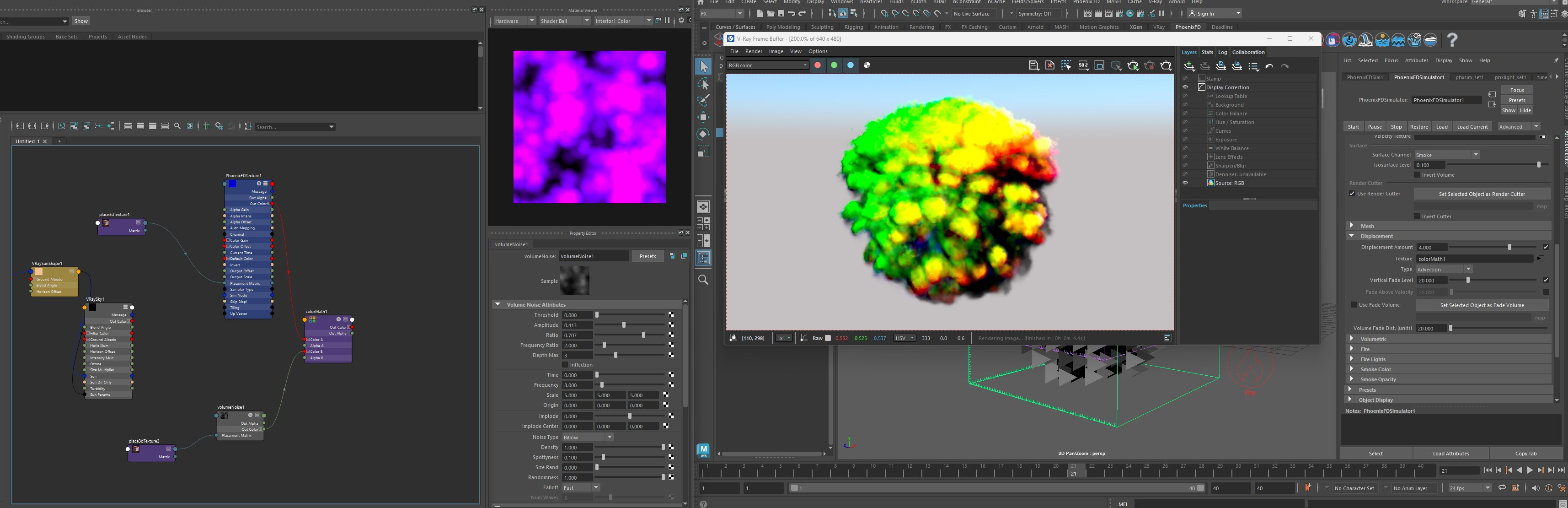

        Sure, here is a scene:
        phx_advect_displace.zip
        And here is the setup I used:
        Hope this helps!
