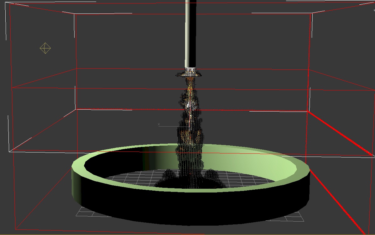

          ok good to know. And sadly another question on a different topic but I didn't want to create yet another thread.
          The "rocket" animation is pretty long in distance so using 1 simulator box is not really applicable here, so I saw in another thread that its possible to use more than 1 box. I tried that method and encountered 1 problem. After the overlapping part when my rocket leaves the first box the flame splashes onto the upper side of the first box. Even tho every side of the simulatorbox is set to open.
          I modified the rocket sample scene to test the method.
          Cheers,
          Oliver
          https://www.artstation.com/mokiki
            select the lower box in the exclude list of the upper box. but i'm afraid that connecting fire simulators is more complicated than connecting liquid simulators.

                  Well those two methods have to do it then. btw excluding one of the boxes did the trick.
