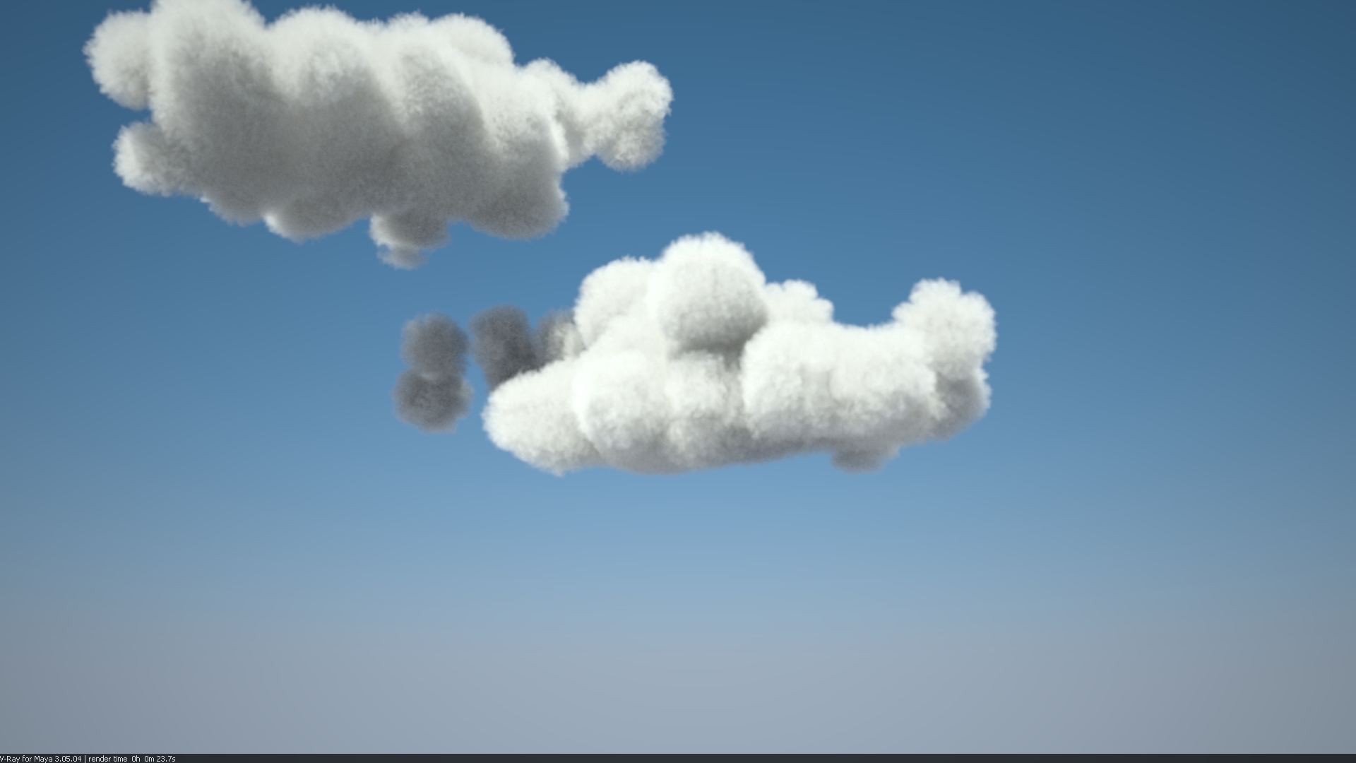

    Hi,
    There have been couple of posts already on creating clouds with Phoenix,
    based on those info and some fumefx tutorials I am trying to simulate clouds using phoenix similar to the ref image.
    I have a base geometry to emit smoke from.
    These are the settings i have used :
    Temperature disabled in the source.
    In the simulator,
    Units : Meters, Total Number of cells : 14M
    Smoke Dissipation : 0.4
    Vorticity : 0.1
    Conservation : buffered, Quality: 20
    Advection: Multi- Pass.
    Smoke color : simplecolor
    Density : 0.12.
    Added Phoenix Turbulance node with
    size 2.0 and Multiplier 5.0.
    I simulated for 20 frames and rendered the last frame.
    As you can see surely I am missing something here.
    It am not able to achieve the whispy details at the edges and
    the over all noise inside the clouds.
    Any suggestions on how i can improve on this.
    Thanks in Advance.

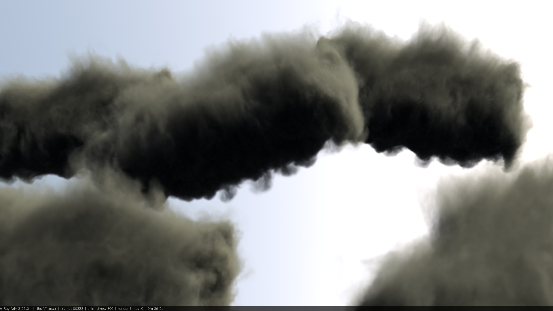

    i really doubt that with this approach you can achieve the reference image.
    the clouds have their shape from the all scale turbulences, large, middle and small. if you try to fake the large and middle scale turbulences replacing them with a source geometry, using the simulation only for the fine surface turbulences, that is the result.
    we really have to make a tutorial, because this is frequently asked question, but for now my suggestion is to create a source plane with mapped discharge, and to emit smoke, render only the upper part of the grid with the caps (use gizmo to cut the lower part)
    ______________________________________________
    VRScans developer
      Hello,
      Some more ideas:
      From your shot it looks like the turbulence wasn't strong enough to kick in visible. Try to increase the scale of the turbulence and the power.
      Also, add some noise on the PHXSource object, there is an option there - this way you will get more interesting base shapes, instead of the spheres that occur right now.
      Another thing you can do is to use render-time displacement - in the Rendering panel, enable Displacement and use Surface or Gradient driven with a monochrome texture, or Vector with a color texture. For the first two modes you have to set the Surface to Smoke and the Surface level to 0.5.
        Thanks Ivaylo and Svetlin ,
        That helped quite a bit. I tweaked based on your suggestions.
        So far it looks promising.I will have to tweak a lot more on the shapes part as well.
        I will also try with the plane with mapped discharge for the further away clouds.
