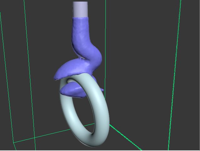

    I have a Question. I work with one of the newest Version of Phoenix FD. I tried to achieve a really vicous Fluid stick to a rotating Torus. Is there a Parameter like Friction for Objects? Why is the Viscosty Parameter restricted to 1? I tried alot of Versions but can't achieve what i want.

      bummer. That's exactly what I'm dealing with. As can be seen here liquid with viscosity 1 is melting away.
      Any hints?
      Uh, I should have read the "Can't get the viscosity high enough" thread in advance. So I will try to decrease the gravity...

        So, according to the advises from "Can't get the viscosity high enough" thread, I reduced gravity to 0,1 / 0,0 - this only helped little to improve the sim. The melting was reduced a bit but shape got lost again.
        As a 2nd approach, I increased the scene scale to 10. This took much longer. And although this prevents the melt of the liquid, but again the shape gets lost.
        - What can I do to preserve the shape?
        - SPF is 10, cell size is 0,001m, total cells 48.483.774 and there is still boiling visible. Any hint?

            Here is another try. As you can see, I cranked up the settings.
            Overall, it looks better but far from good yet. The cream keeps its shape slightly longer than before... but is still melting.
            Maybe there's a workaround to kind of freeze the emitted liquid to avoid melting and boiling?
            Preferable would be to achieve that without other 3rd party plugins like Frost.
            Is the Phoenix mesher capable of that?

                  So, I did another sim with gravity deactivated. Unfortunately, this has brought no improvement. It looks pretty similar to the previous version.
                  Did not check for the boiling yet but this is not my major concern anyway since the particle based smoothing worked well for previous tests.
                  Just to clarify, I have to increase the surface tension to get more stiffness, right? Or is it the other way around?
                    if in the test the surface tension is on, 100% this is the reason for the shape loss.
                    the surface tension pushes any edges inward, disable it if you want to keep the shape.

                      checking...
                      I'll be damned! That does the trick.
                      So, I have obviously interpreted that parameter the other way around.
                      Thank you!

                        hi there
                        the animation below is what i wanted to copy. but in my simulation the fluid got cut in pieces. i will post some pics here.
                        kind regards david

                          maybe i found out what i did wrong i cranked the "motion velocity effect" all the way down to 0.0 and in other tests to 0.1. then the fluid was cut into pieces. now i tried to crank up the motion velocity effect in the right click menu for my object and it worked. what exactly does this parameter mean?

                            This is the pushing effect of a moving body over the fluid - 1 is the natural effect, and by setting it to less than one or more than one you can make an object push the fluid more strongly or weakly than it should in reality.
                            Cheers!

                              Just a quick update on the latest approach.
                              Here is the rendered version:
                              Liquid still has some down movement but I guess that could be fixed by decreasing the gravity.
