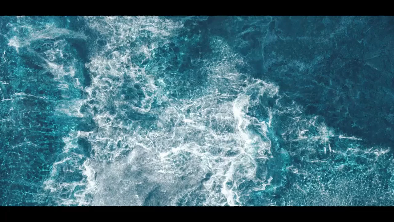

            here's the rendered simulation i'am sittin on. still wip though

              Nice Loving the caustics
              Adam Trowers
                Wow, looking awesome!
                  thanks! Still strugglin with the wetmap though.. dont like the part on the up right corner where the water hits the rocks. resimulated the wetmap over night to prevent too fast drying. but coudln't get good result yet..
