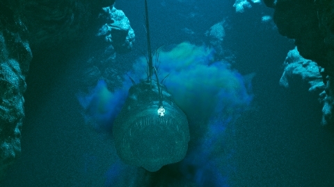

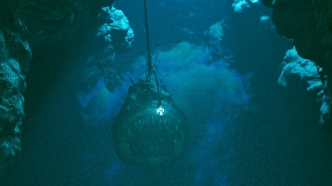

    Hey there,
    I´ve run into another issue when rendering phoenix smoke grid in volumetric mode with vray environment fog. I remember reading that that is an issue and
    I can fix this by rendering in volumetric mode, but then render times are a lot higher, and they are already pretty high...
    Is there another fix for this?
    I´ve had good experience rendering everything in one pass for a different underwater shot, so I´d still like to do this way and don´t wanna go back to comping it...
    Any advice on how to speed things up otherwise?
ID:	1006268Click image for larger version
    Left is with volumetric mode, render time: 2.22m, right is with volumetric geo mode, render time is 19.17m. And that is still very noisy and only 480X270 and no vraydisplacement...
    If there is no other way I will have to try if I can render in volumetric mode and then color correct the volumetric atmosphere pass.
    Final shot will also have DoF baked in, so I´m not sure that will work...
      Hm, thinking twice...I´d have to render the volumetric smoke as an extra layer, just using the atmospheric element won´t work, since vray environment is in there as well of course...
