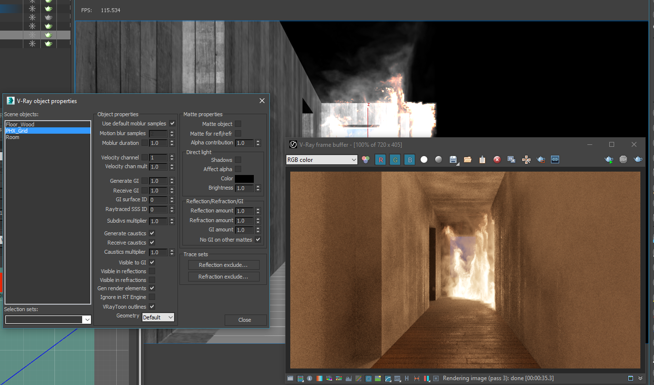

      Hi,
      actually the light emission is clean. It appears to be the glossy reflection of the Phoenix grid what is causing extreme fireflies. If I turn off light emission I get rid of the smooth clean lighting and the scene is distilled down just to those firefies. I can not really make Phoenix grid invisible to reflection because it has no such switch in Vray object properties, and it ignores the visible to reflection/refraction switch in 3ds Max's native object properties.

        Ok, so I've randomly found a combination of properties which makes it work. I have no idea why it works, but it does, so I'll take it:

              Just wanted to thank Ludvik for posting his solution -- I was having the same issue. Disabling those 2 VRay properties solved my "fireflies". Thanks!
