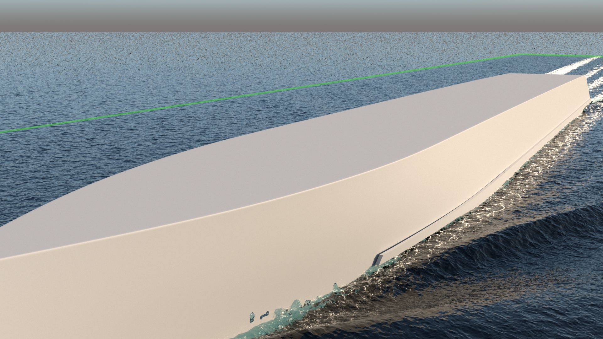

    I've created a sea simulation of a 300m long ship, but foam is not visible in places where I'd expect there to be.
    Of course, the ship is symmetrical
    I've created the sea simulation over 78 seconds with a large grid volume of 200m cells (cell size 300mm, System Units in Meters) - I've also allowed for a long Outside Life of 60 seconds to leave a nice long trail for the Foam and that can be seen clearly in the Perspective shot (you can see clearly the 'trough' created by the grid volume and the foam outside of that).
    So, for that view, you can see lots of foam along the side of the ship, behind it and even foam outside of the simulation volume - so far, all good
    But then......

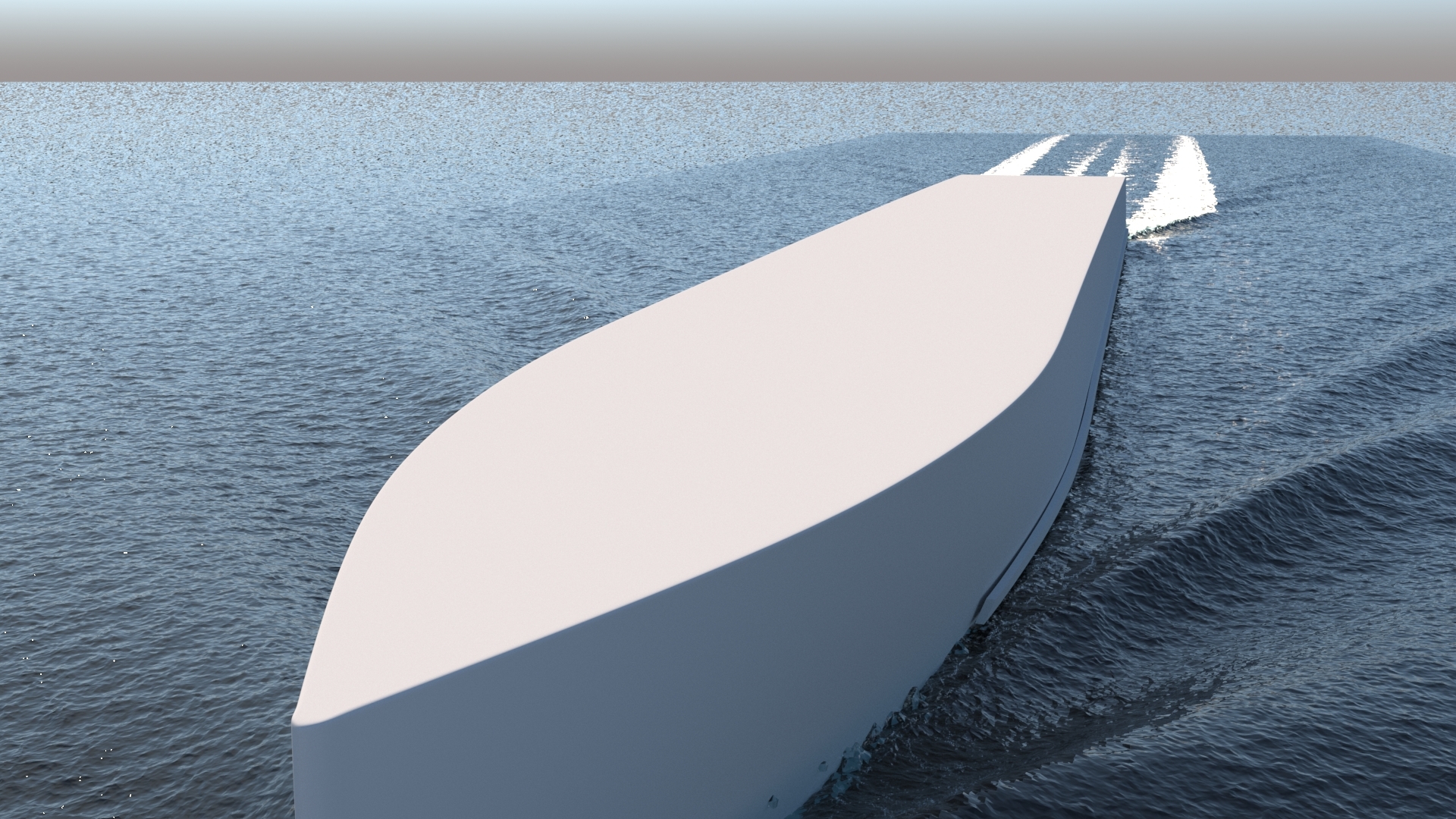

    ......look at the camera view with foam on the left of Camera - there is NO foam at the back, after the outside of the volume grid - you can clearly see it cuts off early at the back off the ship.
    Furthermore - when the camera is on the other, camera right, side (i.e. seeing where the ship side is in shadow) - no foam is visible. Or rather, it is clear that foam is 'missing' on that side. Again, in that view too, there is also no foam at the aft of the ship outside of the grid's volume - that foam ends abruptly at the end of the simulation grid edge.
    I used the latest production Phoenix FD (as per my signature) - and this simulation took 14 days (on a 7980xe) and we're not going to re-simulate !
    Any help please would be much appreciated.

          I have attached another screen grab to show you where the foam ends at the end of the grid ) )
          Furthermore, my tests I did this morning regarding why no foam on the shadow is of the ship - when I move the sun over to what was the side in shadow, yes, we then see foam !!! (and I checked the previous side where there was sun, but now no sun as it has become the side to be in shadow, and then that has no foam visible so foam seems to be visible only when there is direct v-ray sun !) - I am sending you guys the scene file and a couple of cache files.

                    Secondly, I have discovered that for my point 2) ie no foam visible outside of the container, I stand corrected. They are there, BUT they are VERY faint !
                    Also, I do now get foam on the sides of the ship in shadow (it seems my ground plane fixes that).

                          I've tried what you said but the nightlies made it worse - in fact, simply installing the nightly https://nightlies.chaosgroup.com/dow...45_install.zip,
                          I get renders with no foam at all.
                          And the issue with the container edge visible is still there (see attached).

                              Hey, so first regarding the missing foam - the particle shaders got disconnected from the foam and splash particles during conversion from the old scene format - there will be a fix for this case in tomorrow's nightlies, and you can work around that by picking the simulator's foam and splash from the 2 particle shaders manually.
                              Now looking at the ocean issues.
