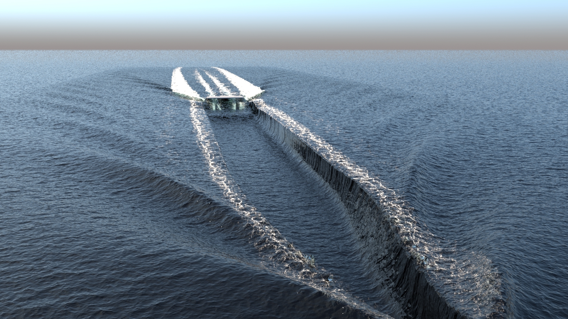

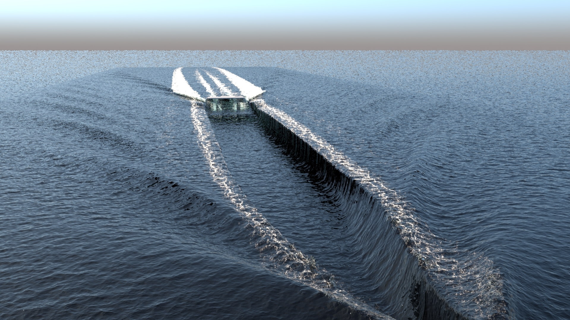

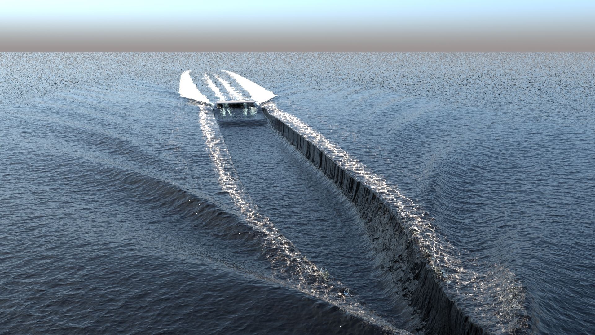

                    Hey, today's update:
                    I added an additional step to the ocean meshing that smooths out the container surface in the distance and the render has improved a little, but the issue is not resolved yet. The changes will be in tomorrow's nightlies so you can try them on your setup where you have improved the material shading and check how it looks. Here are some renders of your setup with the old version I have - the original render of frame 2120, the same frame with the modified algorithm, and the modified algorithm with 8 ocean subdivs (the difference in peak memory usage is 19 vs 43 GB or RAM):

                    • #25
                      Hi Svetlin,
                      I'm *extremely* grateful that you're providing such attention to my issue, thank you so much.
                      It's certainly an improvement, thank you
                      The 8 subdivs is going to be a no-no - when I tried that myself, (to improve the noise in the sea), my render times went up a lot (7x if I remember rightly).
                      Tomorrow's nightlies is good, and if you need a little bit more time, that'd be fine - at some point next week though, we're going to have to pull the trigger and render out these pups
                      So if that little bit of extra time might help, it's there if you need it.
