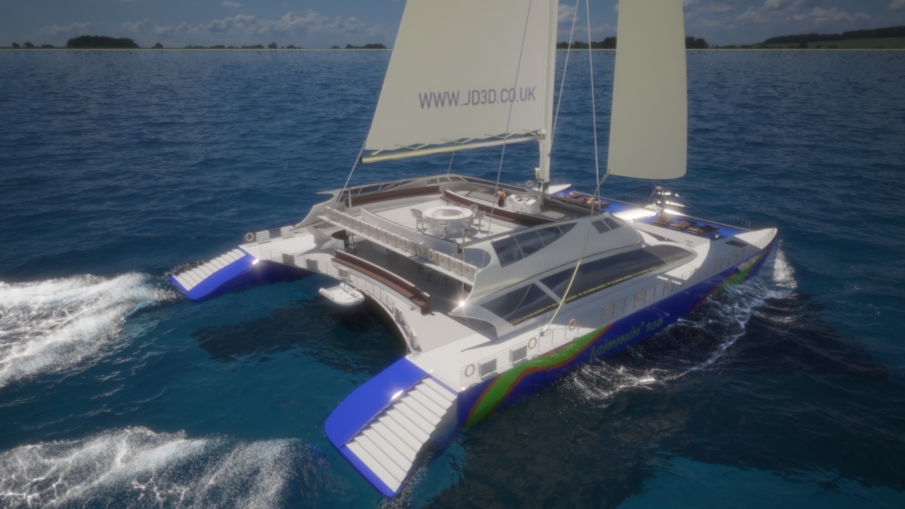

Pretty simple problem really - as the title says.
Foam and splashes do not render when Vray Aerial Perspective is turned on.

I think there is just something wrong with how things are drawn into the distance... look at these tenders, two different machiens (AMD and intel) - notice the the horizon is is not reflected in one?
If that was the only problem I could render to one machine, but there is sill flickering.http://www.jd3d.co.uk - Vray Mentor

Originally posted by Svetlin.Nikolov View Post... or if reordering does not work for the particular scene, switch the Simulator into Volumetric Geometry render mode and enable 'Render as Geometry' in the Particle Shaders.

Also, that horizon line issue - seems to be the vray ground plane - seems as if the ocean levels keeps bobbing up and down - fiddlign with the smoothness and roughness doesn't help.
The ocean horizon just doesn't like the vray ground plane - which is essential for shallower water.http://www.jd3d.co.uk - Vray Mentor

SIf you are already rendering in ocean mode, you don't want to put the simulator in volumetric mode. If foam and splash flicker, then it's the particle shader's 'render as geometry' you need to enable.
