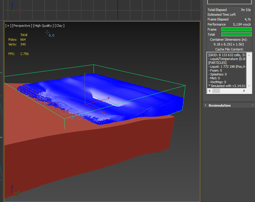

            Same with 2080ti and 1million of water particles. I don't know why, but I don't use water particles preview and you shouldn't. Also, it tends to be faster, when not 1:1. F.e. adaptive is kind of 3.

              Particle preview and voxel preview have Auto Reduction by default. If they get too heavy for the viewport with the GPU you use, they will bump their Detail Reduction automatically, until the viewport is responsive.
              However, GPU preview does not support Auto Reduction, so for large data you can increase the reduction manually. The gpu preview is also drawn by a pixel shader, so basically the more pixels you have in your viewport that show the Phoenix simulator, the more calculations it would do. So the size of the viewport, the number of viewport where you draw the gpu preview, and your screen resolution might cause it to draw slow.
              Unfortunately, 3ds max's viewport tries to be universal and so we don't have direct access to the gpu. A standalone voxel preview prototype we quickly wrote runs several times faster than the Max and Maya viewports, so unfortunately this is how it goes currently
                Well, you never know, why smth is not working. Just thought that it is somehow linked. 1million particles just cant be slow nowadays. But, maybe it is on todo list. Who knows...
