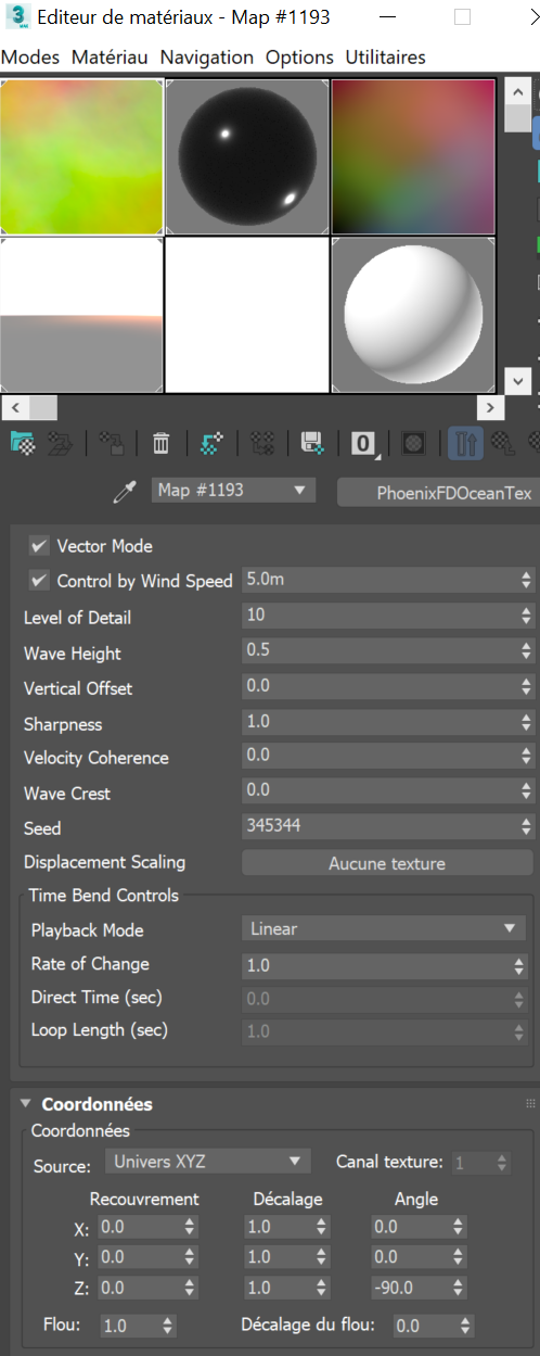

        Ahhh, okay, can you check the Mapping of the Ocean texture in its Coordinates rollout below its main settings - is Source set to World XYZ?
          Here is my texture, I am in coordinates universe is that why?

            Should be the same as World XYZ, thank you!
