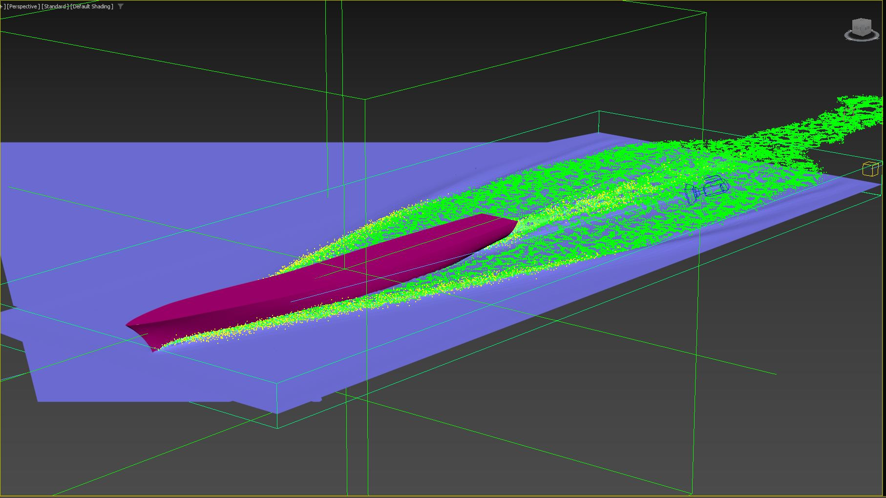

    I've set up a basic ship simulation where a ship is moving through the water. I have an issue with the resolution of the waves hitting the front of the boat and the waves moving away from the boat. They are blocky. I already have the grid set up 0.135m which I know isn't small but to go any lower means seriously increasing the sim time to the point my machine with 64gb is struggling.
    Is there no way to have the resolution of the sim more detailed at points where the waves are created and then less detailed as the wave height falls off?
    I'm guessing that right now the only way to get a better looking sim is to lower the grid settings?
    Am I limited by my hardware? I'm guessing the studios all have much better spec machines...

      Hey Steve,
      sadly for now there is no way to add more grid resolution only to certain parts of the sim.
      From what I can see in your case more grid resolution is the way to go. Is it possible to shrink your grid a bit? Also can you show us how large is the grid relative to your boat in the viewport?
      Also can you share the Cache File Content info for your sim? If you have too many secondary particles (splashes,mist or foam) this might slow things down in terms of simulation speed.
      Can you show us the settings in the Dynamics rollout as well?

        Here are a couple of screen grabs showing the setup. The cache sequence is 332gb in total....

          I had asked also about a possibility to refine the grid resolution. It would definitely be handy to have a finer grid at bow, but we don't need this definition all over the grid.
          www.mirage-cg.com
            Indeed, increasing liquid's resolution via resimulation is already in our to do list. It is an important feature in the toolset.
            As for the scene settings, you do have 28 milllion foam particles, combined with the foam volume option and the 4 steps per frame, this takes quite some time to calcuate all the bubble interactions. You can try to reduce the foam to 1-5 million by lowering the foam amount or reducing the foam on hit in the splashes settings and this should speed things up simulation wise.

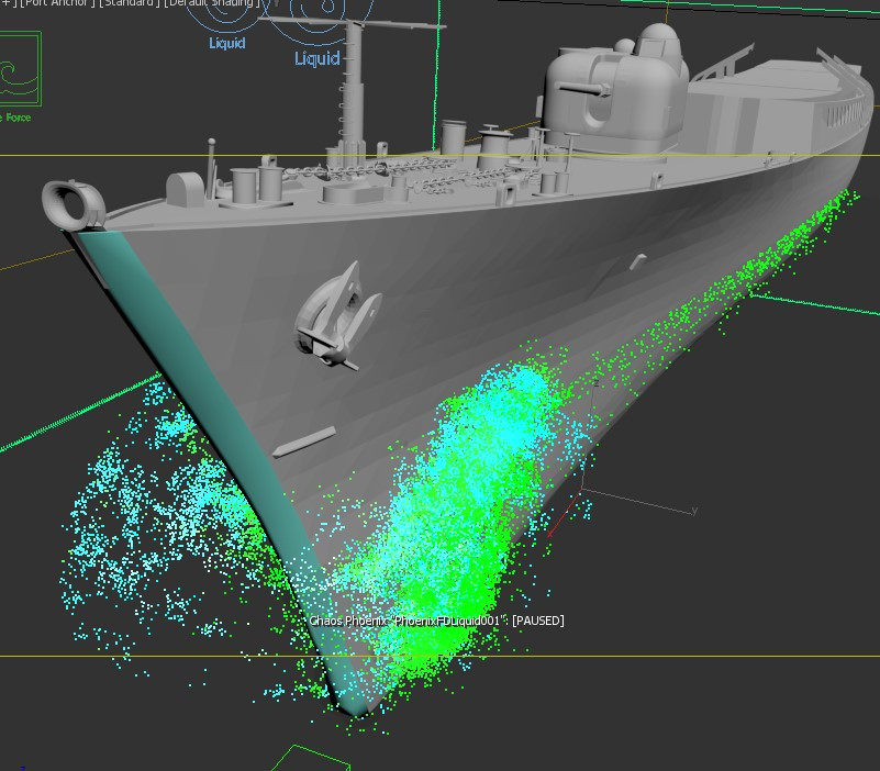

                Steve,
                Try detaching the prow as a separate geometry, then link it back to the ship.
                Change the shape of the prow to flatten the front faces and widen the back so it pushes and deflects water. The width of the prow may need to be as wide as the grid cell size to push the water.
                Set the Phoenix Motion Velocity Effect for the prow to a higher number. Tune and experiment.
                Hope it helps and good luck!
