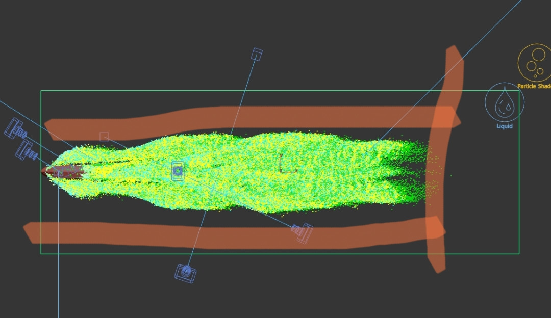

              Looks like there is so much of the grid that you can shrink - try making the grid narrower like this:
                Additionally, you could make the grid much shorter if you use the Max Outside Age options of the Foam and Splash: https://docs.chaos.com/display/PHX4M...ading-Lifespan
                Beware that this might change the way the foam trail looks like, but it's worth trying as it will reduce your resolution tremendously. Try to set the Max Outside Age of both the Foam and Splash to a large value (in seconds), such as 30 or 60, and then make the grid short like this: Click image for larger version
                  And then, if the simulation looks okay after these changes, then you could increase the grid resolution in the Grid rollout so the droplets would be smaller.
                  Cheers!
