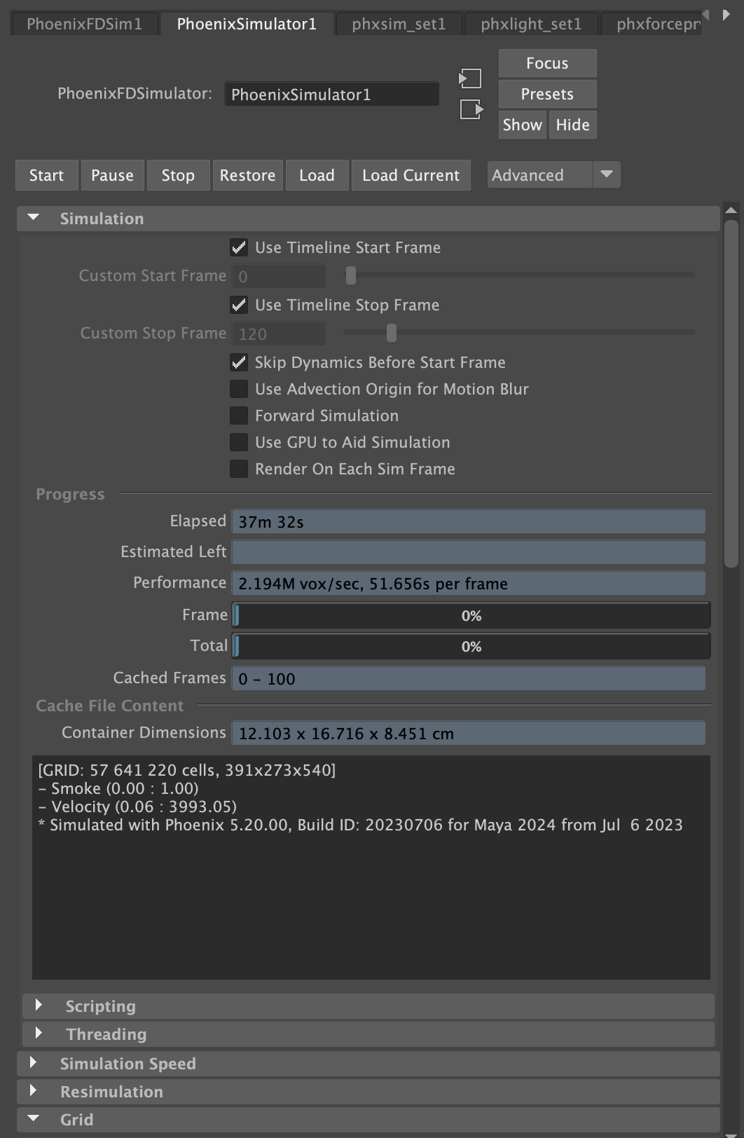

      Hi Slavina
      We're on:
      Phoenix
      Version: 5.20.00, Build ID: 20230706
      V-Ray
      V-Ray 6 for Maya, update 1 (v6.10.00 from May 22 2023)
      Here's the first settings for the Simulator and Source.
      Is there an easy way to upload all settings? I don't think I've changed much
      Cheers
