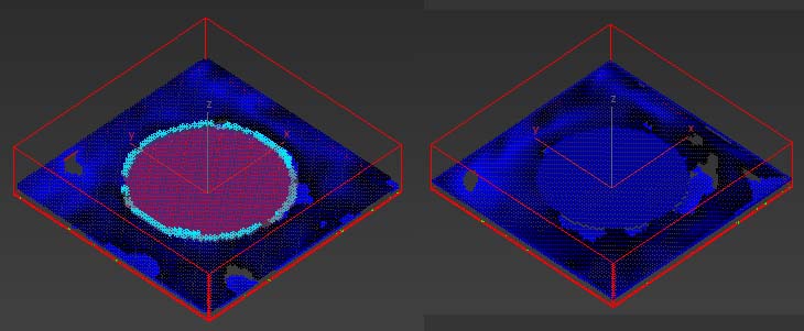

    basically, i wanted to remove the splashing at the grid boundaries where the simulation meets the infinite sea :
    which turned me to the nightlies that doesn't splash at all
    which led me back to the official build and mask out the borders in post, problem solved, only not within phoenix

            • #21
              what is this circle in the center of the simulation?
              ______________________________________________
              VRScans developer
              • #22
                that would be my collision geometry, the lower part of the rig from this shot
                the film is already finished and the client was happy. it is now just a matter of research to improve the workflow for the next project
                • #23
                  now i understand your problem
                  actually, what produces the activity? don't forget that the displacement waves are fake, they can't produce splash. i suspect you have no activity in the simulation.
                  in the old builds you have splash, because we had a bug, the thin layer of liquid produced splash, even without motion.
                  however, this bug is already fixed. in this thread i suggested you to use the ocean texture to produce real waves. did you try this? it's not so easy, but you goal is not easy at all.
