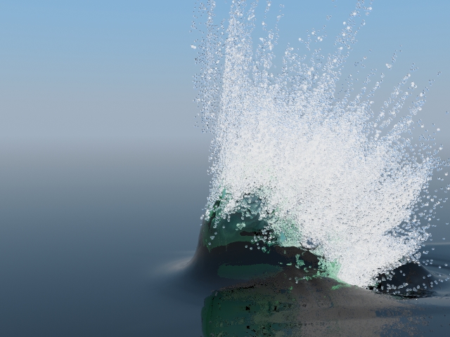

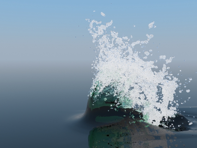

      if you will resimulate, i would recommend some improvements:
      - desired splash count 500k-1M, export the velocity and use motion blur in the rendering, it helps a lot!
      - use the liquid like parameter of the splash, let say 3 is good, but may be smaller. see the images in the attachment, the left one has no liquid-like enabled, the right one has liquidlike=3 this parameter makes the splash to behave as pieces of liquid.
      the porshe image has motion blur of the splash and liquid-like=3

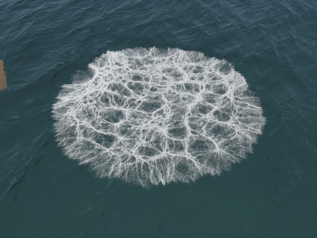

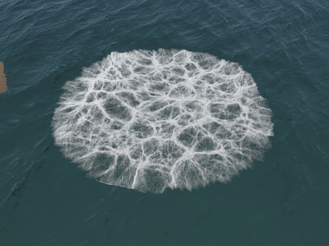

      b2b interaction:200. this option is cpu consuming, you can skip it but the foam will become string-like pushed by the pattern forces, see the attached images
      half life:0.2 sec if b2b is used 1 sec otherwise. if use b2b, use the "vary" option, it makes the single bubbles to live shorter (requires b2b, otherwise no info for bubble neighbors is available).
