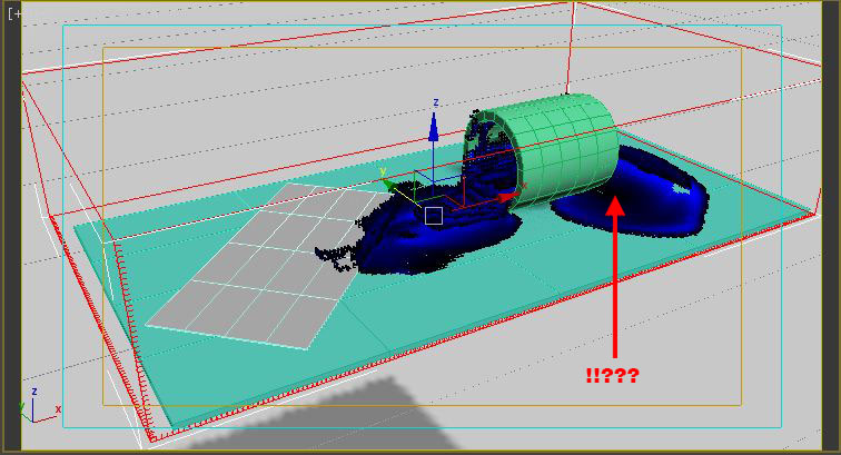

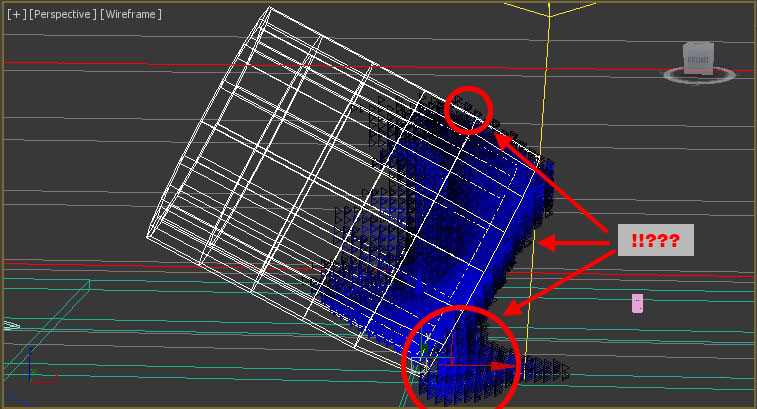

    Issue nr 1 :
    When a glass filled with liquid is knocked off and falls on the ground, the liquid has a weird behaviour and disappears through the glass's bottom.
Name:	Liquid spill 1a.jpg
Name:	Liquid spill 2a.jpg

      The first issue is easy to handle, it's described here in the help.

          It seems I had not properly bound the simulator to the cylinder. Now that I did, the result remains unchanged.
          there is no matter who is the parent, the point is to make the glass geometry not moving relatively to the grid in order to avoid the penetration in/through the walls
          there is one more option - your walls are too thin, remember they must be at least two cells wide. Increase the resolution or the gasses bottom.
