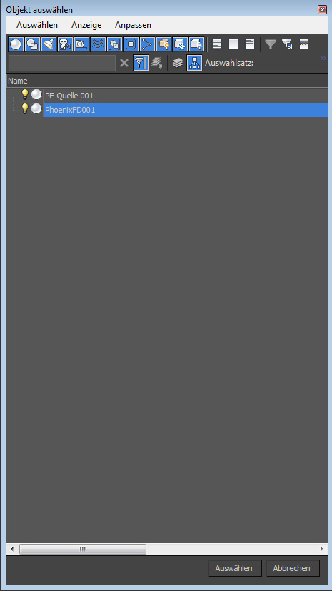

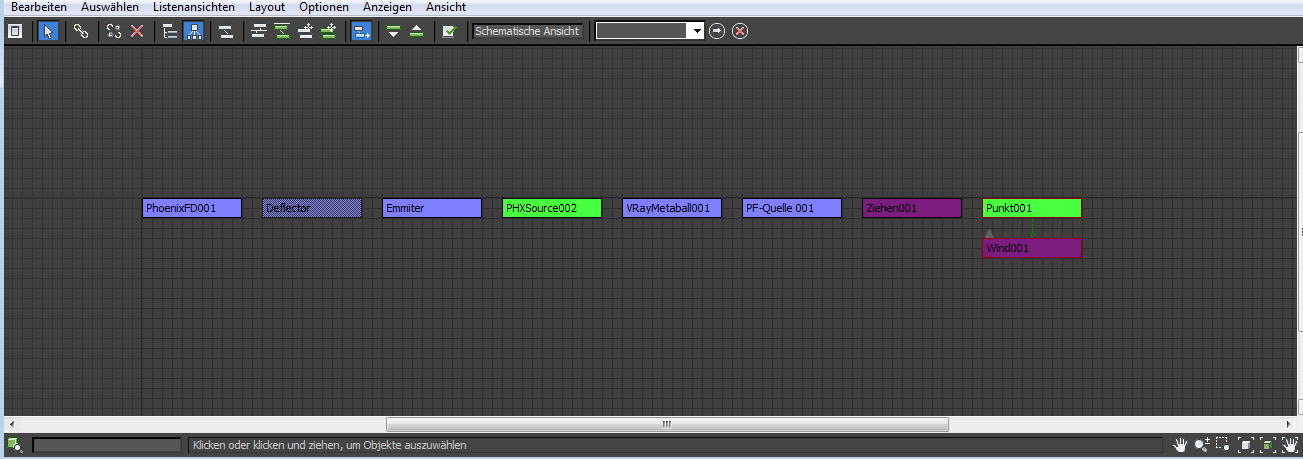

      Thanks for the reply. I tried your suggestion. We use the regular build. Unfortunately I can't seem to find the hidden object you mentioned. Do I have to know the exact name of it?
      Attached the hierarchy of my test scene and the selection window after pressing "add" in the metaball object.

          yes, as i mentioned it's a bit tricky
          the hidden object is produced on demand, and this happens when you create PHXFoam object and select the desired particle group in it. once the particle group object is created, you can delete the PHXFoam.
          then you have to enable "display hidden objects" in the picker, and this should be enough.
          p.s. sorry about that inconvenience, we didn't think that our particle groups will be used in 3rd part plugins, actually its a kind of very happy coincidence that it is possible at all
