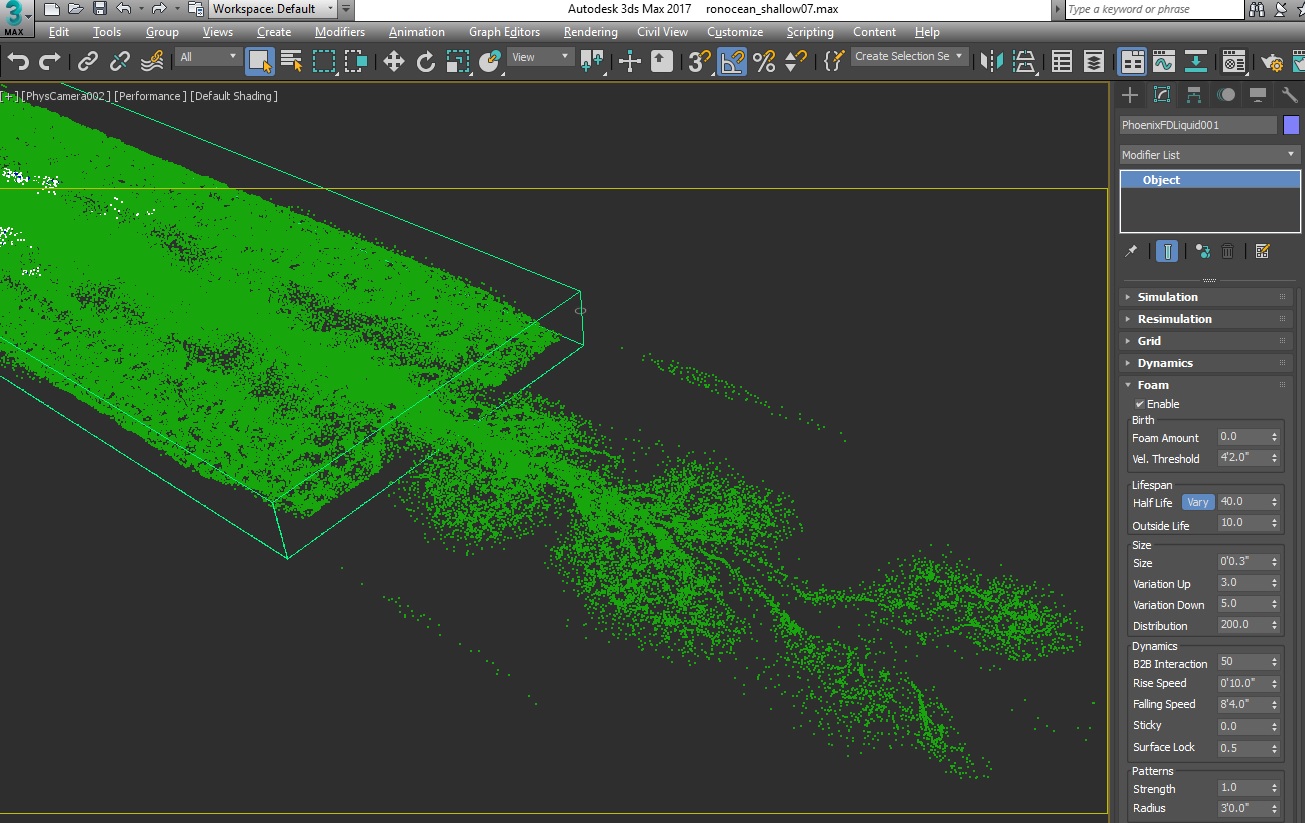

    Still working to generate a ship on the ocean sim. Getting strange results with foam life outside the grid.
    Nightly phoenixFD_adv_22501_max2017_vray_30_x64_26847.
    This is frame 588 of 2000, attempting a resim to add splashes and foam. Detail reduction 2 in this screen shot.
    cache.aur file size 412MB. Grid 73M cells, Liquid 25M, Foam 14.8M, Splashes 65M.
    Seems as if only the foam particles with higher velocity are escaping the grid. Most of the foam is killed at grid even with outside life set to 10.
    Any suggestions?

    Hey,
    Does this happen only when you resim? Otherwise, the Outside life topic was discussed here in the forums not long ago - we will modify its behavior at some point, but for now you could check the other thread for more detailed explanation and try increasing the outside life.

        Update:
        This is starting to take shape thanks to the tip from Svetlin.
        Increasing the foam Outside Life from 10 to 20 helped some. I think it needs to increase even more. Grid 72.8M, liquid 25M, foam 17.2M, splashes 67k, mist 380k, no wetmaps. Noticed foam increased 3M.
        The warship is at full military power run of 32 knots. I am impressed the sim produces good big rooster tail in the wake by itself. I need to also increase discharge rate of emitters on the ship screws to increase foam activity at the transom.
        I understand now the foam particles from the rooster tail are able to exit the grid easily but foam particles from the bow wake are too slow at the back of the grid to cross outside within their lifespan. This adjustment gave the foam trail the expected taper and can be improved with more outside life.

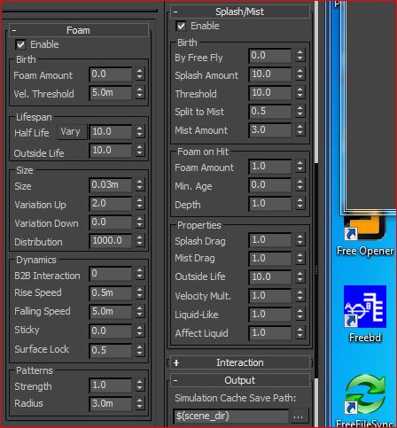

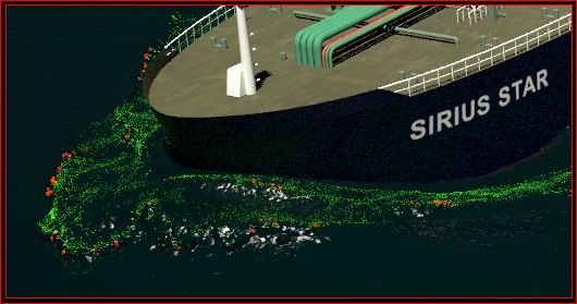

                            the results from a simulation I described in a post 07-16-2016, 02:08 AM with these foam/splash settings:
                            were:
                            foam green, splash red, don't know what the white particles are
                            refined the Foam settings and resimed:
                            results: foam particles probably too small, splash and the white particles still the same size.
                            Q1. In v2.2 there was a splash size setting. how do we manipulate the splash/mist size now?
                            Q2. If I did not do the resimulation, would I be able to achieve similar results by playing with the particle systems settings?
                            • #15
                              The direct splash/mist size control was removed, because it leads to significant problems in the render setup. When we initially introduced it, the idea was to follow the general physical correct model, however you can't simulate a ship or waterfall with the real particle size and count, the particles are just too big in count. The real pipeline is to use lower in count and bigger in size particles, that works pretty well. Using manual size control, you have to guess what size to use with the current particle count, and this was hard for the most of the users. That's why now there is automated count-size relationship, controlled by the parameters splash and mist multiplier. The meaning of the multipliers is how many result particles correspond to single parent particle, for example splash multiplier 5 means that single liquid particle is turned into 5 splash particles, when the physical correct model is used (affect liquid=1). The multiplier determines the splash size giving in account the volume preservation, this makes the setup much easier.
