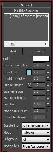

      Ivo, please clarify which exactly is the multilayered you are mentioning here "splash multiplier 5 means that single liquid particle is turned into 5 splash particles". Is it the simulations settings:
      or is it int the particle system settings:
        It's the splash amount.

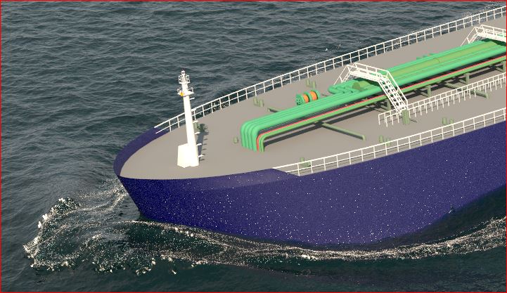

          have been playing with the splash amount number.
          cell size .3m, grid 75 mil
          splash amount =20 (stolen from the ship example)
          liquid 45 mil, foam 107k, splashes 1700
          both foam and splash looked grainy, but splashes looked rather large particles

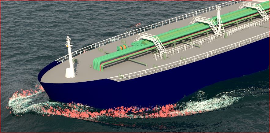

          one more try: up-ed splash amount to 100
          result: foam 396k, splash 54.9k
          splash particles size still noticeably large (tinted red to be distinguishable)

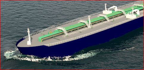

              Ivaylo, you sensed it right. There must be something not quite right with the build I am currently using (2.25.01 Nightly Build ID: 1607126855)
              On May 23th I ran the ship scene you had posted in March. I don't have record of what nightly I had used, but It took 13 h for 500 frames. The rendered video looked excellent to me.
              this is what I kept form that sim:

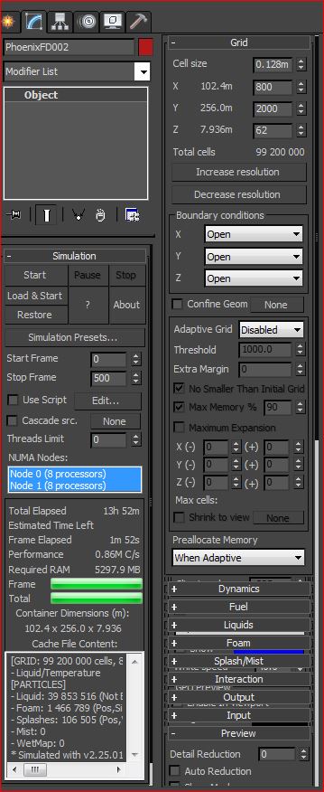

              Yesterday I started simulation of that scene and in 25 hour it was only on frame 470.

                    Did as requested Svetlin - simulated the ship/FLIP scene with 2.25.01 Nightly Build ID: 1608036879.
                    took twice as long to crunch 500 frames as with the whit the nightly from May (28 h vs. 14h):
