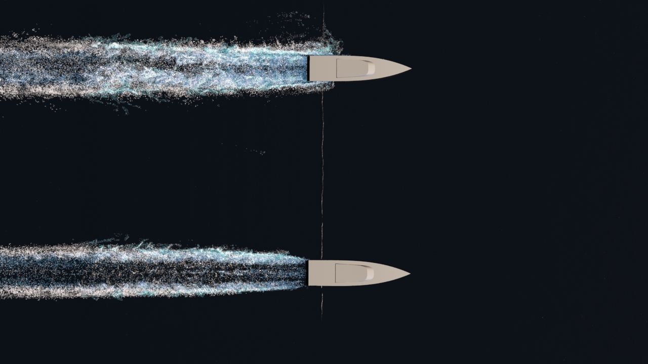

        I changed "PHXFoam001" and "PHXFoam002" particle shaders to "Geometry mode" made no improvement to the stepping.
        At this stage of the animation there is no "noice" added to the simulation and I guess it could be the undisturbed sim grid that is propagated to the renderd image. And since the upper boats hull is causing more disturbance it is not noticable until later in the animation. notice how the stepping is concentric in shape.

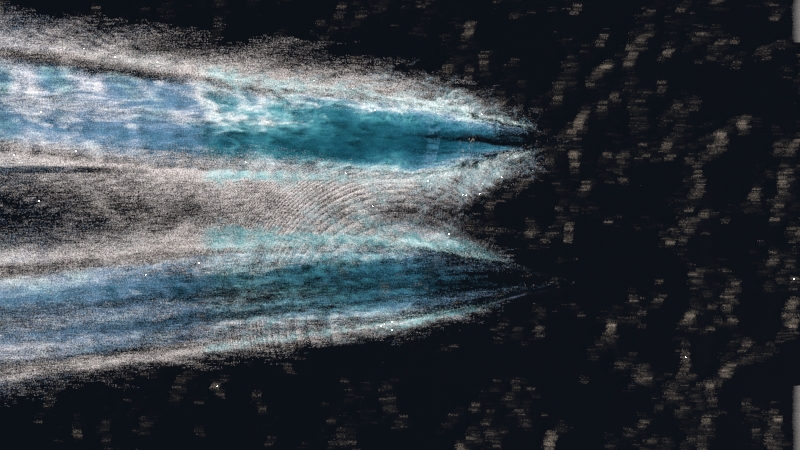

          I installed yesterdays nightly build and upped the res of the grid x2. (got myself 64Gigs of RAM)
          and latest official Vray.
          There is still the same issue with the motion blur creating steps in the wake behind the boat.

          • #20
            Very interesting - in that case, would it be possible to send the scene or a stripped version in case there are any valuable assets to Support? Btw, is your particle shader in point mode?
