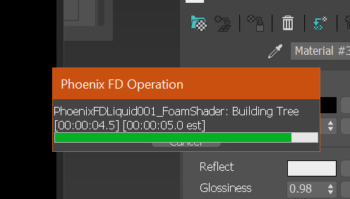

            Seems like there is some miscommunication. You should see a progress bar, saying Optimizing Congestion, etc. There should be a Cancel button. What exactly happens when you press it?
            Svetlin Nikolov, Ex Lead Phoenix developer
              There is no cancel button on the version I have , only a narrow box with the ''optimising.....'' as this grab shows.
              AHA! i just saw it when I uploaded this image - it's obscured by the rest so I missed it completely. Maybe there is a way to change that box size?
                Ohhhh, this is so messed up. What is your exact Windows version, and do you use any display scaling or a 4K/high-dpi monitor? We gotta break this here and make sure it's fixed...
                  Yeah it's 3040/2160 monitor, which I figured might be the problem. Win 10 home 1903 build 18362.719. EDIT: Scaling is on - forgot I had that checked, so that'll be it I guess.
                  At least I know it is there and it is clickable, so no major worry/rush
