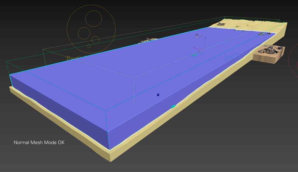

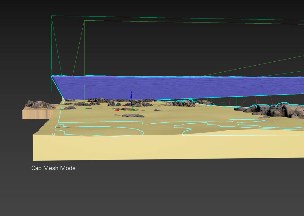

      Talking bout quirks, i right now stumbled over something else, i'm not sure i understand it. Please have a look at the attached pics.
      First pic what you see is the complete scenery. As you can see in normal mesh mode all looks fine. Beach and rocks are fine solid objects and are blocked out correctly.
      When i want to later on render that in ocean mode i just realized something strange is happening.
      When changing to cap mesh mode as you can see in the second pic. There's is that part of fluid in the beach. So wouldn't see it anyway right but when changing to cean mode it seems it wants to connect somehow and creates those strange artifacts at the borders down to the ground. Is this normal behavior and i just oversee in the past or is there somehting completely screwed up in my scene? Maybe i should send it over hihi

        I'd guess it has to do with Fill Up for Ocean and Clear Inside - check the info on Fill Up For Ocean here - there also is an example linked further down the page: https://docs.chaosgroup.com/display/...iquid+Dynamics
        • #34
          ah ok! that's a direction at least, cool. But reading the docs again, to get rid of it, what can i do? Should i set the beach and rocks to NOT "clear inside" the
          Update: Jep! That seems to do the trick!
          nicee thx Svetlin.Nikolov

            Yay! Indeed, in FLIP simulations you don't need Clear Inside if the geometry is Solid - particles can't get inside and if they somehow do, they will die anyway. Unlike grid fire/smoke simulations where Solid and Clear Inside can be combined.
