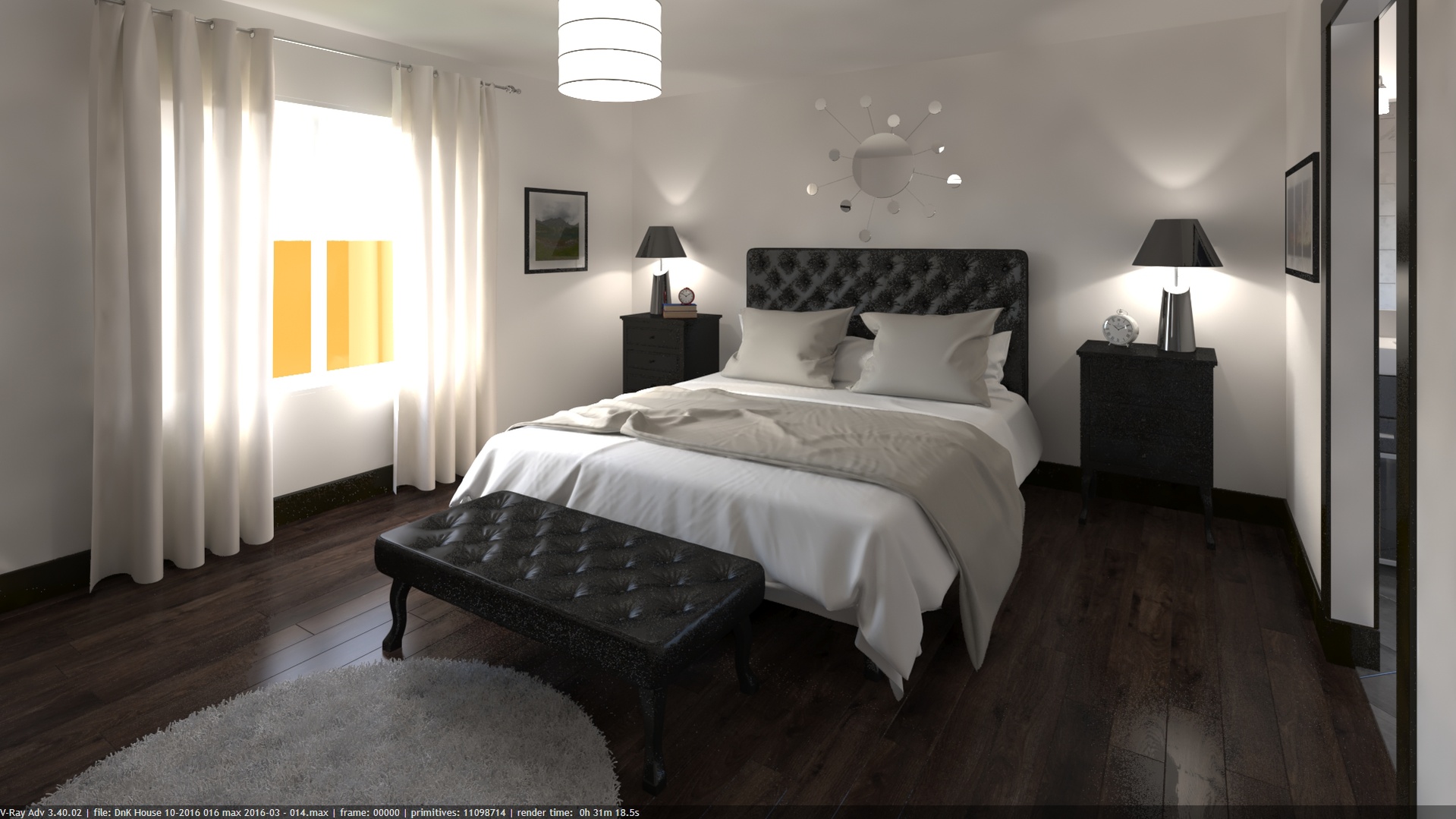

Holy crap just did a test between V-Ray 3.4 on 3dsmax 2016 and the bedroom image that I posted the other day and rendered it at 1920x1080 and it took 31min 17.9sec on my laptop, then installed 3.5.03 and re rendered it with all the same settings and it came in at 17min 30.8sec !! Thank you Chaos, you still continue to blow my mind after all these years.Below are the two images
