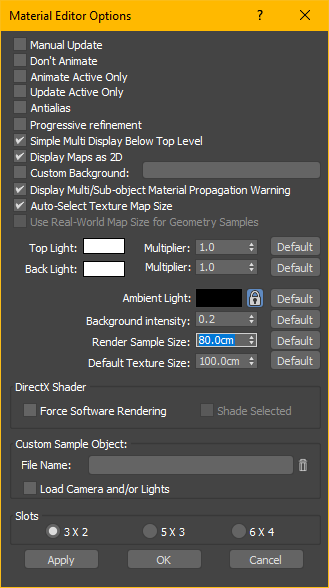

    For now, matching materials with RWS between the material library and the material editor, needs user input: the default material size in the material editor options needs to be set to 80cm (or 31.5 inches).
    Do *not*, under any circumstance, edit the swatch scene, as the script relies on it being exactly as shipped, and would break otherwise.
