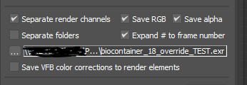

        Nope, we're not. We're using the output path of the frame buffer in the V-Ray settings. Actually, it was the first thing we checked.
        If you enable the output path in the frame buffer settings, the path shows up in the asset tracker, though.

                      Anyway, here is the test with Vray Raw Image file. Same crash right after building the light cache:
                      [2022/Feb/22|15:32:52] error: Cannot send asset \XXX\RENDER\PREVIEWS_TESTS\override_TEST\biocontai ner_18_override_TEST.vrimg Error opening file: [PFileStream::Open] 2: (2) [RenderClient::getStream]
                      Settings for saving:
                      Click image for larger version  Name:	assets_03.PNG Views:	0 Size:	18.3 KB ID:	1140820
                      Edit: The vrimg gets saved though, it is here. But crashes still

                              Alright, here is the next test. I used your script to delete the older output entry with success:
                              Click image for larger version  Name:	assets_05.PNG Views:	0 Size:	10.6 KB ID:	1140855
                              So the render setup window now looks like this:
                              Click image for larger version  Name:	assets_06.PNG Views:	0 Size:	21.2 KB ID:	1140854
                              Crashing, still. Same message as before.
                              [2022/Feb/22|18:18:56] error: Cannot send asset \\XXX\RENDER\PREVIEWS_TESTS\override_TEST\Test_v01 .vrimg Error opening file: [PFileStream::Open] 2: (2) [RenderClient::getStream]
