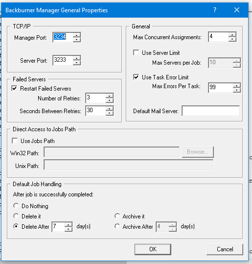

            Originally posted by ^Lele^ View Post
            I found a jira entry about BB failing for asset transfer errors (although that was for GPU), with a possible fix: turn on the max task error limits (in the BB Manager) and set it to some number higher than 1 (the default of 4 should do it.).
            See if it avoids the crashing.
            I tried it with the settings below and restarted the manager. Sadly, this did not work either. Will try restarting the whole farm tomorrow, but it is busy making noises.

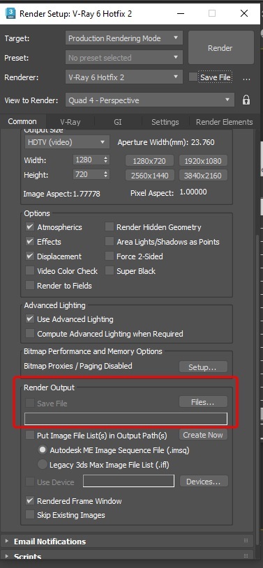

                      Hi you have cleared and disabled this path, right?
                      Click image for larger version  Name:	3dsmax_2022-08-16_16-40-21.jpg Views:	0 Size:	83.8 KB ID:	1157317
                      Vladimir Krastev | chaos.com
                      • #26
                        Yes, 100%.
                        • #27

                          Backburner detects some of our warnings as fatal errors. Could you please try to disable the user task error limit in the manager here.
                          Also, make a test and decrease the verbosity level to 1 here, or set the log window to never. Let us know how it goes.
                          Martin Minev | chaos.com
                          • #28
                            I already did this to no avail, see my posts in this thread from 22 an 23 of February.
