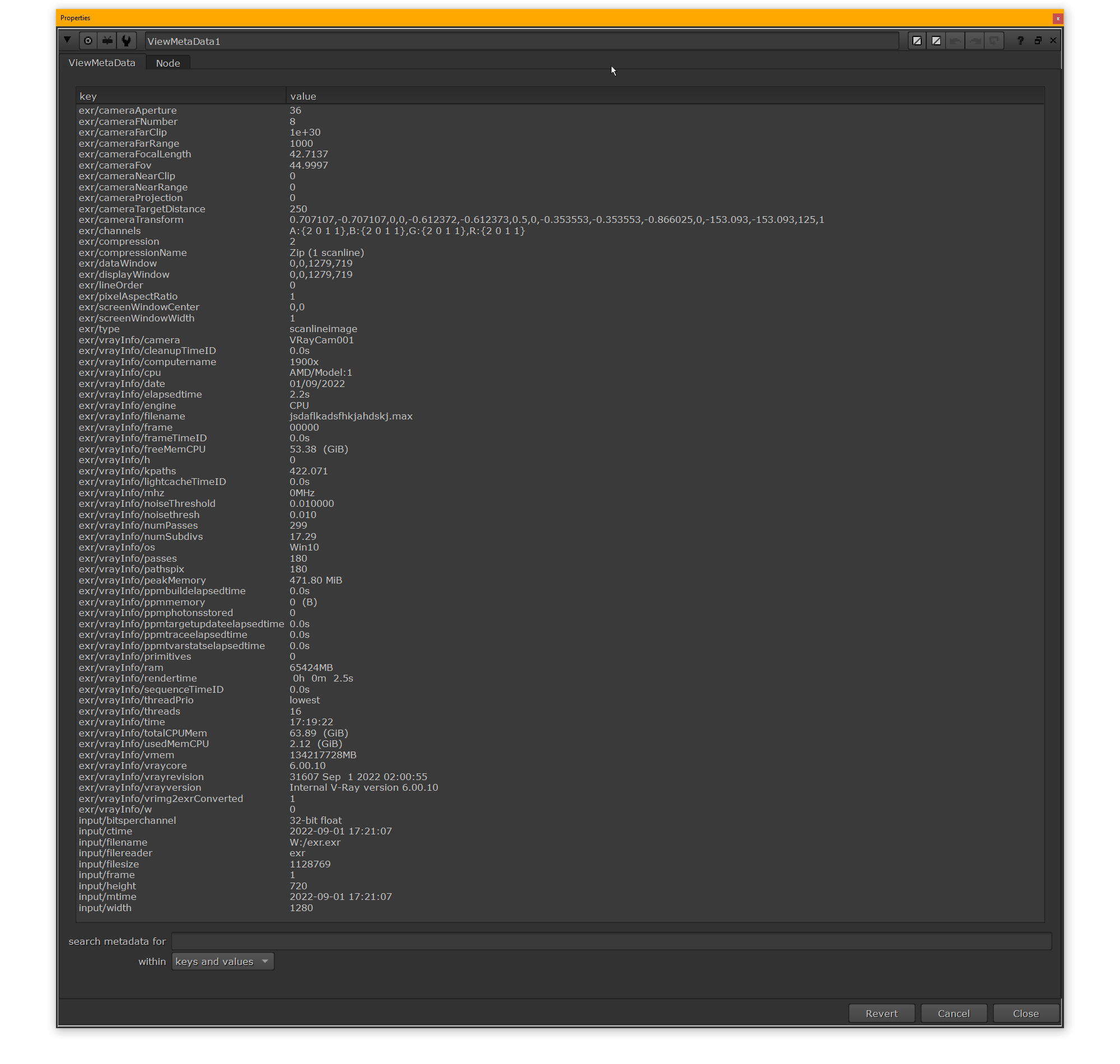

    Yes, the metadata *is* saved in the converted EXR.
    If you save an EXR from the raw file save dialog, the metadata will be filled for you.
    I am however unsure if windows' file properties are able to read openEXR's specific metadata at all.
    Use nuke, or equivalent tool, to be sure of what you have written in the file.

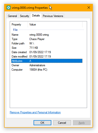

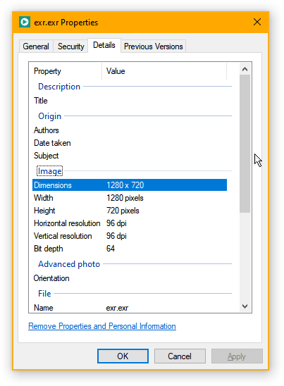

    I have tried this out, and indeed it's just the reading being wrong for windows file properties: see attached (exr converted from the vrimg)
