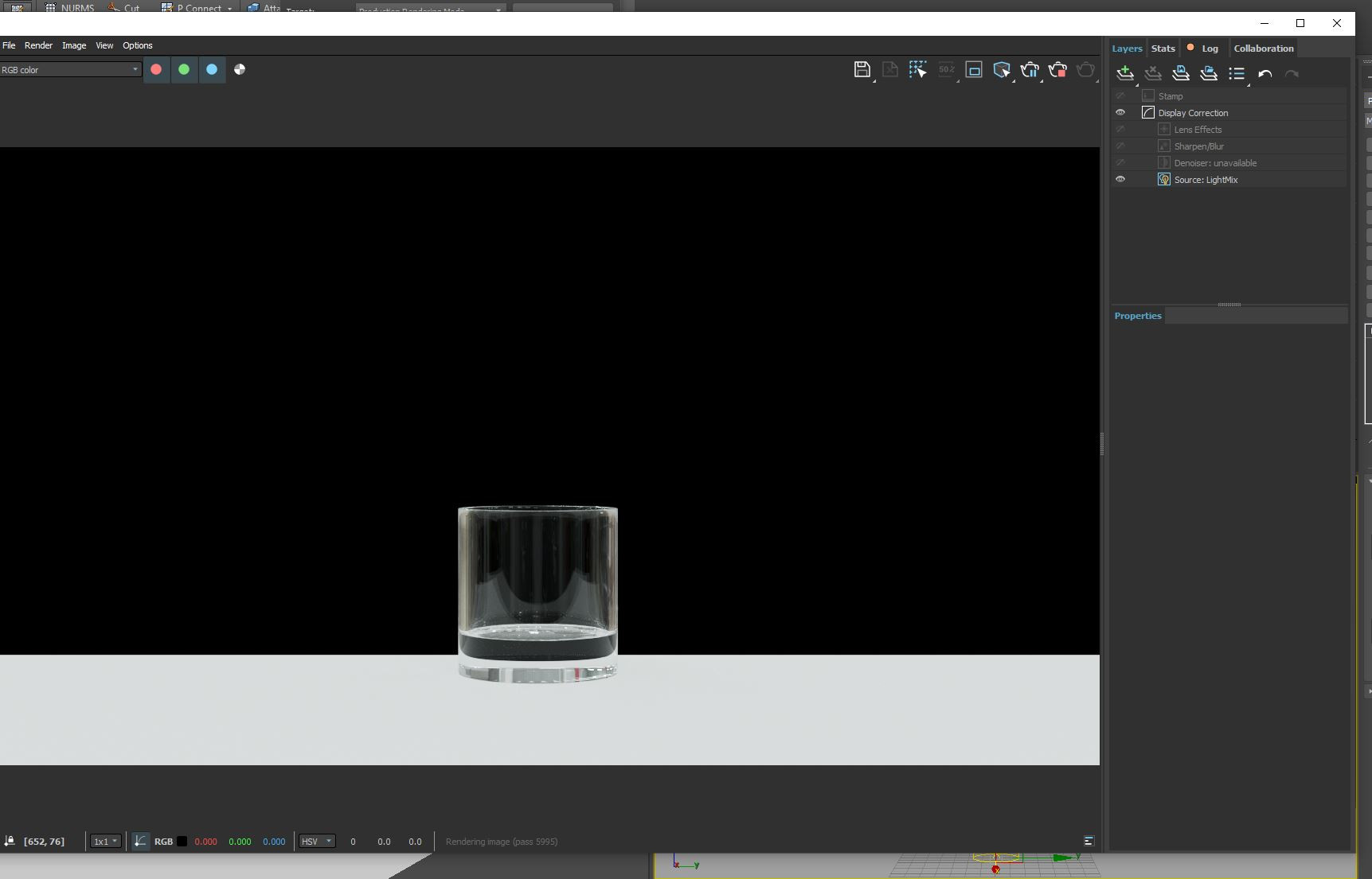

      Thanks a lot! That helped me a bit already. I exported the exact scene that I had in Blender to 3ds max. Same HDRI, standard VRay glass material but no matter what I try, the result is never rlly satisfying. I attached both results that I got right after rendering with no additional corrections. (I´ve tried playing around with the glass material values in VRay, too, but without any success).
        Looks like the Blender glass is perhaps less transparent? Also I think it has reflect on backside turned on, some texture maps or procedurals for dirt and variance, and perhaps a better environment (lighting setup)
          So, after tweaking the materials and lighting a little bit I managed to get a result which is comparable to the one that I have in Blender . Thanks a lot already for your help!

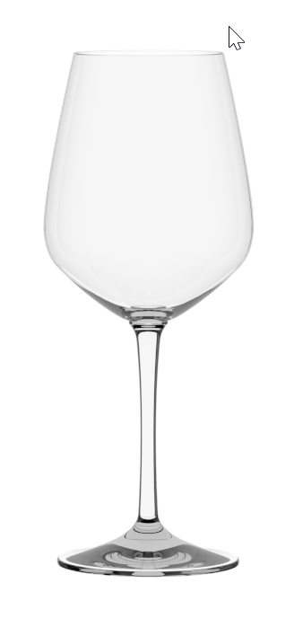

                Depending on the shape of the object and how it reflects, there's not one perfect setup. This image is
                a stock Cosmos glass (minus liquid) with no ground plane, one plane light as a backlight and 2 invisible black cards
                which are visible to refl/refr which add some definition. Shown with a white bkg.
                So variations on that theme may be what you're after.
