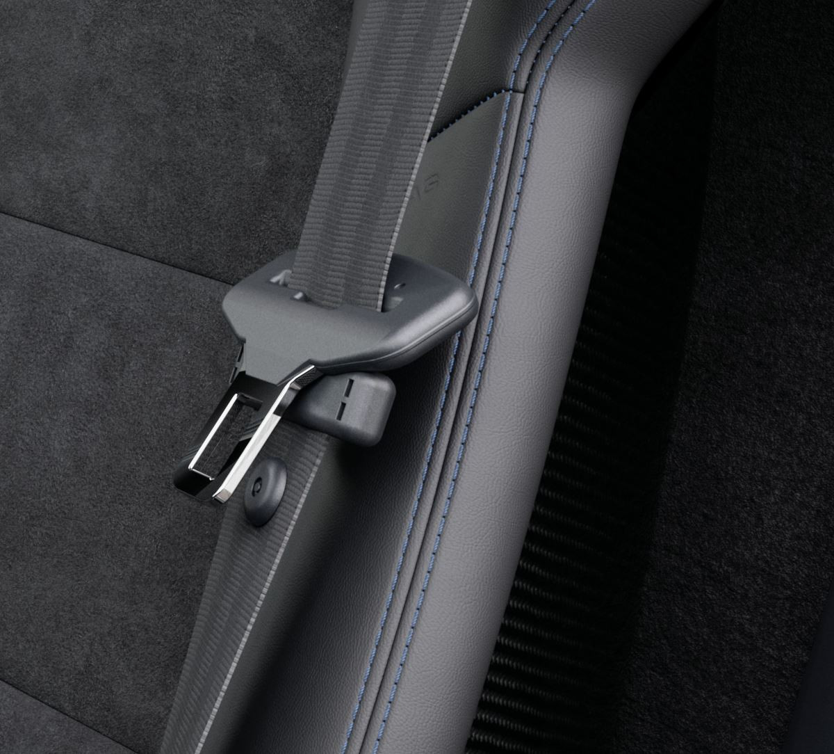

                We did the stitching in the past with the old 3dsMax object paint. That one can place objects along a spline.
