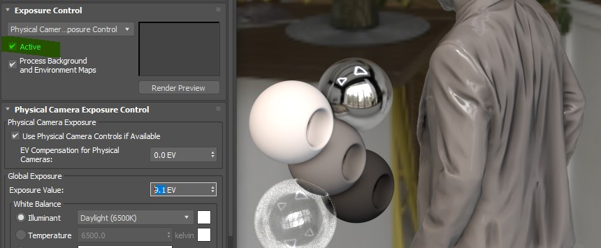

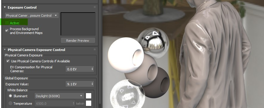

        are you using any tonemapping in the viewports?
        Click image for larger version  Name:	Screenshot 2025-02-03 112401.jpg Views:	0 Size:	68.7 KB ID:	1226255 Click image for larger version
Name:	Screenshot 2025-02-03 112755.jpg
ID:	1226256 Click image for larger version
Name:	Screenshot 2025-02-03 112718.jpg

          no, and ambient is at black too.
