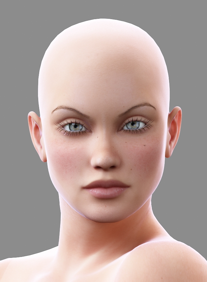

    Hi,
    I have been trying for a very long time to create a realistic render.
    I have read many posts and think I am getting closer.
    However I can never seem to capture the realism I am after.
    I think it may be due to my render setup/environment and lighting, rather than the shader setup.
    (see attached.. poser model I am skin shader experimenting on)
    Any thoughts, setup and comments would be most appreciated.
    ps.. although this link is MentalRay, this is the realism I want to achieve with VRay
    http://www.cgarena.com/freestuff/tut...irl/girl3.html
    Regards,
    Adam

      Well, one thing that comes to mind is that the link's lighting is very different than yours.
      Skin is also SSS, and if the hair cover half the face, it's hard for light to shine through and illuminate it.
      Try rendering the lady without hair at all, and only afterward compose the hair on top so that your render looks good enough.
      Lele

          I'd say the skin is the strongest element in your image. Lighting needs to be cranked up (and more colored lights/ambients) and your hair seems a little flat, maybe more sheen? The eye lashes look a little spider legs to me and the eyes could use some work, possibly more wetness/highlights. I think the last thing that I noticed is the skin lacks bump, almost waxy, too perfect. Give her some pours and imperfections.
          Almost there though, just needs polish.
            Thanks everyone, will try and add some more lighting, prob some extra hdri for colour, eyelayses fix, etc...
            Will keep you posted.
            Adam

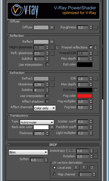

                  Well I removed my Environment lighting, hair and placed some vray lights around the place.
                  I noticed that I wasn`t getting any sss effect (ie light wasn`t showing through the ears).
                  I dropped the fog multiplier down to 1.0 (from 2.0), and that seemed to help a little... tho since I am still learning here, I am unsure if that was the best solution, if i am heading in the right direction or it was merely a band-aid solution.
                  Tho, now the character`s skin is looking `hard` to me. Also, I don`t think i really have the sss working properly.
                  Most likely lighting.. still is playing a big part in me trying to make it look more real.
                  Any help would be most appreciated.
                  I have attached my vraymtl settings and current test render.
                  Adam.
                    Would be best to use VRayFastSSS2 (or VRayFastSSS) material for this.
                    Vlado

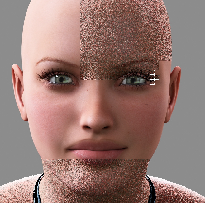

                        Hi Everyone,
                        After lots of experimenting, here is my test using the VRayFastSSS2 shader.
                        I think I still have a lot to do in achieving the result I am after..
                        Still have issues,
                        Maybe too much light.. or the VRayFastSSS2 isn`t setup quite right..
                        Possibly I need more spec to hilight the bump map...
                        Also, am experimenting with the scatter radius. I gave the ears a larger radius than the face.
                        Anyhoo..getting there I think.
                        Feel free to reply with any comments & advice.
                        Adam.

                            Dont fall for the trap of making her look too translucent. Its a subtle thing.
                            Take some reference photos of a real person to try and match that with similar lighting.
